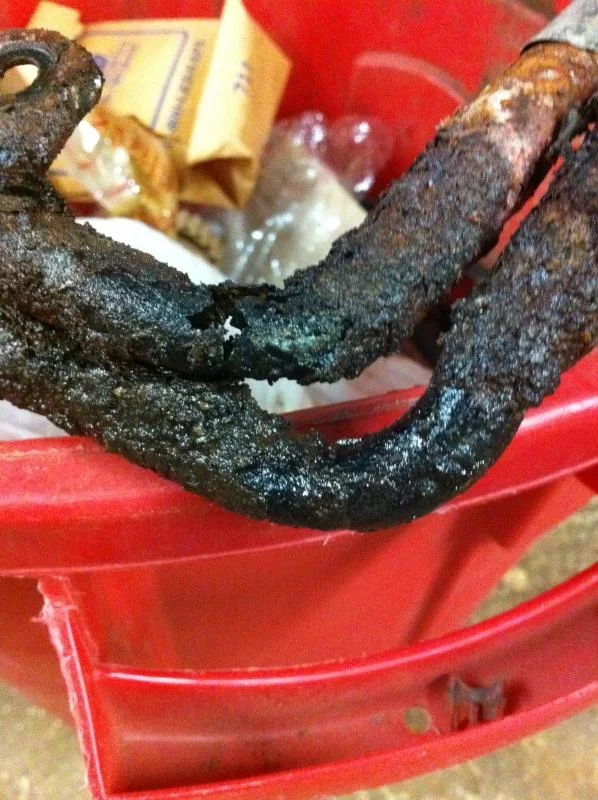

Rear heater bypass was a success. My lines were looking pretty ugly and I didn't even want to deal with them.

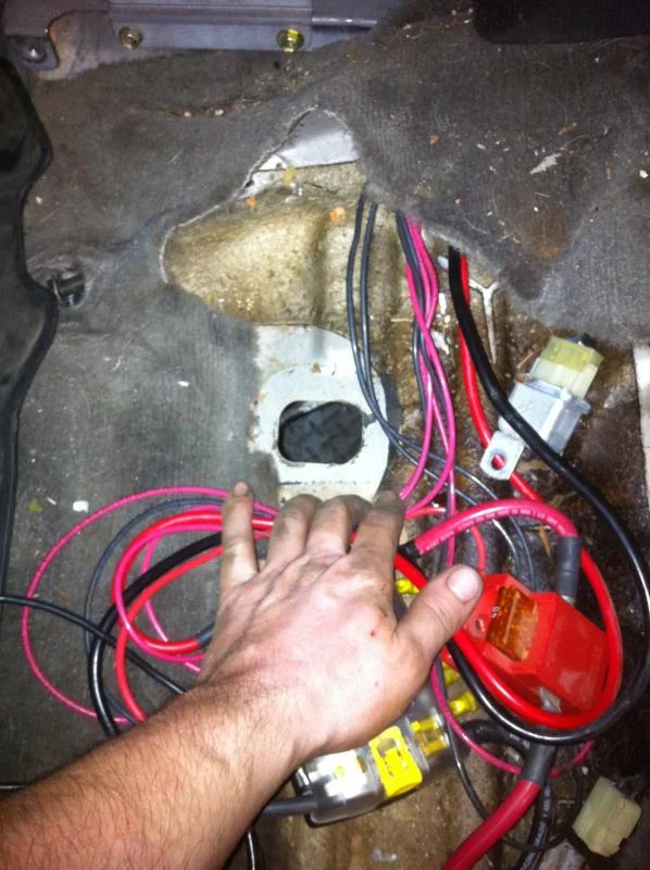

Rear blower hole cover
I have just bypassed the rear heater and removed all the lines... That sucked. The rear blower doesn't need to live under my seat, so
-how have y'all filled the 2"+/- size hole left. Curious to see your ingenuity.
That seems so committal! But that's probably the cleanest way.
I thought about using rtv and sandwiching the whole between 2 sheets of metal.
Thanks,
Jeremy
I would only use one piece of metal. With two, the potential to trap water between and create rust is much greater. Use one layer and paint both sides.
Used a piece of galvanized metal and some JB weld, 2 years running.
