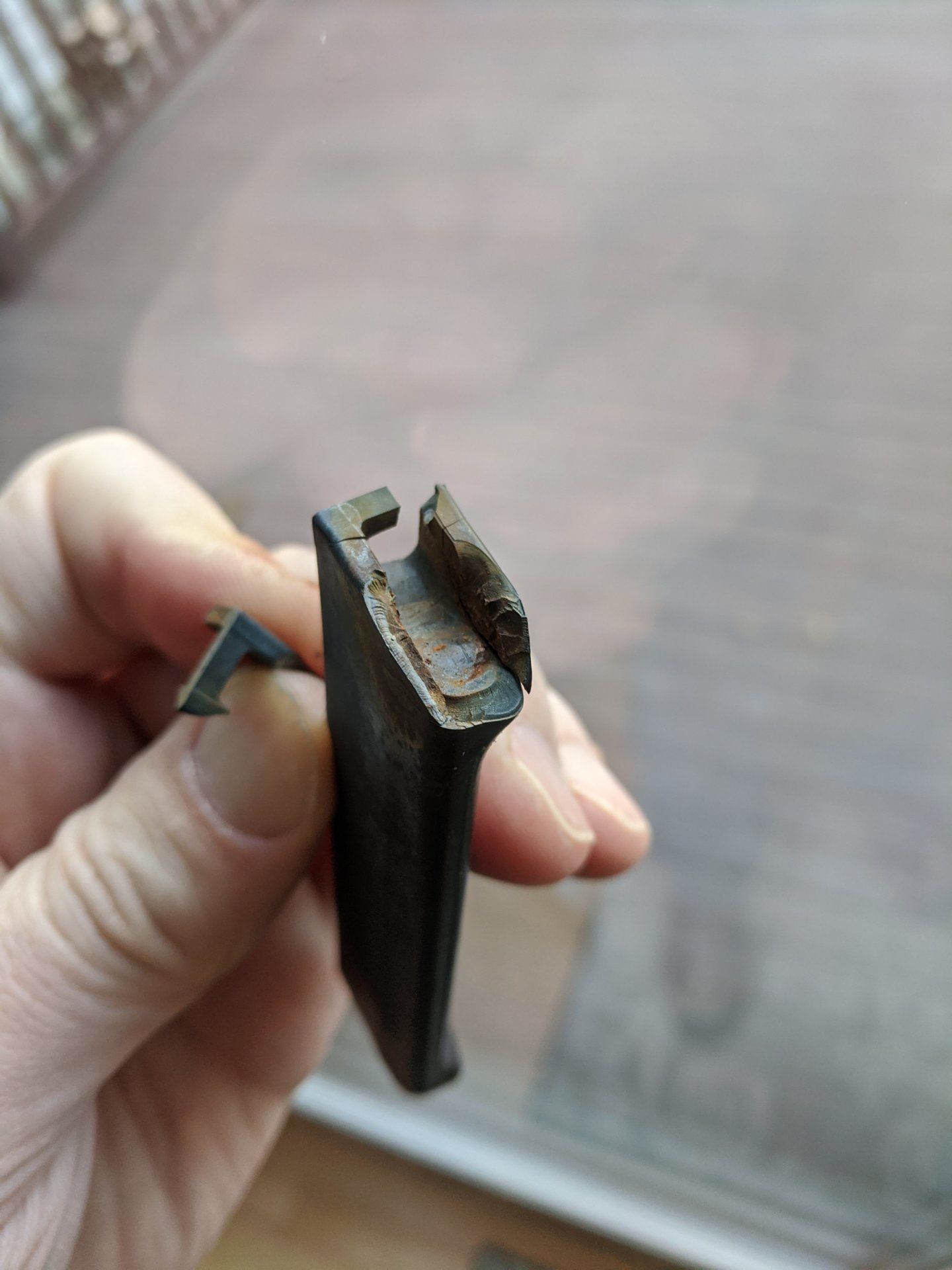

Team- my black plastic handle, that opens the upper rear hatch/glass has been busted ever since I've had my 98 LC.
Can anyone confirm, is this the only piece I need, and is it a simple bolt on/bolt off- or is there more to it than a simple $8 part and what 'appears to be a 10 minute 1banana job'.
Thanks!
Heres my current look and the part link.
Rear Hatch Back Plastic Upper Door Handle 1991-2007 [69215-60020] - $7.99 : CruiserParts.net, Toyota Landcruiser Parts

Hi - yes, it did! Worked out perfectly, and it was a 20 minute job.
Unscrew the plastic handle on the inside, then remove the inside plastic trim. Then on the outside three 10 mm screws. The inside metal piece that the outside handle connects to under the plastic trim is held by 2 10mm bolts. The explanation is more complicated than it really is.

I jumped the gun on my 1998 - did not inspect the breakage carefully. I should have pulled off the broken plastic handle and inspected. I ordered the two parts from Cruiser Parts.When I went to install today I did not find the metal prongs on the latch assembly rusted beyond use. The plastic handle was split on both sides but after sanding down the prongs, which still had remnants of their raised nubs, I could shove on the new plastic handle. I think I will order another plastic handle and keep the latch to repair down the road.

The plastic handle on mine broke off. I ordered a new one. Looks like is just slides/snaps on. Is that correct?
