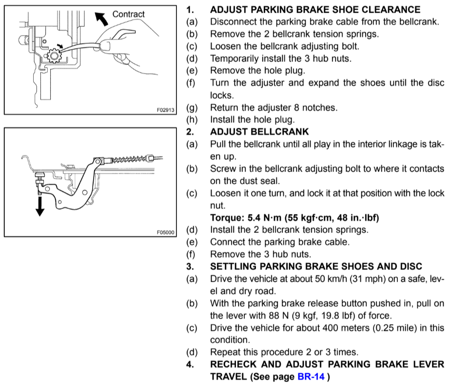

@Mike NXP thank you for this, I discovered that my rattle is greatly reduced when barely enaging the e-brake. Now the question is why? Any ideas on how to troubleshoot/diagnose which e-brake component is causing the rattle?
My guess would be that your shoe adjuster isn't properly set, leaving some loose bits.

Can this be done through the little opening through the disc brake? I'm sure I can find some how-tos on the forums here. Is it worth messing with?
Yep, that's what the opening is for. You can find the procedure in the FSM but essentially you adjust the shoes all the way out until they are making full contact with the drum, then back them off 8 notches. Page BR-38
Thank you gentlemen! Through my testing I realized that my ebrake doesn't work at all (when fully engaged, light comes on, but zero resistance at the wheel...) so at least now I know for sure what's up. Anyone have experience with this kit from cruiserparts.net?
Might be worth taking the time to inspect your e-brake components before buying a kit so that you know exactly what is disconnected, what needs replaced, etc. I took pictures of mine when I was in there doing rear brakes recently but will probably go back in to take inventory of everything missing/disconnected before I spend the coin to get something "too" complete, such as this.
IIRC all you really need to do is pull your wheel, remove and suspend the caliper, then remove your disc/drum to see all of the e-brake components. Page BR-34.
