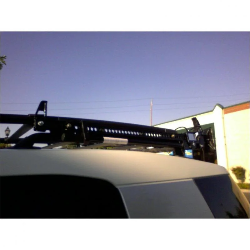

My new rear door set up and I FINALLY got a roof rack and knoll made some Kustom Hi-lift Mounts, WHAT DO YOU THINK?
Where did you get the mounts holding up the stuff on your door?
There isnt realy a mount. I used some small bolts about 5/32 x 2in drilled the hole's in the rear door panel and backed it with some 3/16 pliwood bolted that in then used some butterfly nuts to keep everything in and secure. Inovation in the key
