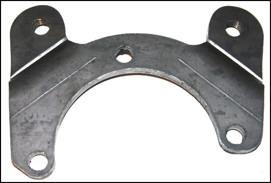

I have this bracket from Ruff Stuff
This is for a rear disk brake conversion on a 85 Toy Xtra cab
And this caliper, they don't fit together without modification, I cant seem to be able to get through to Ruff Stuff and ask them why.

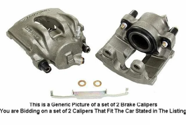

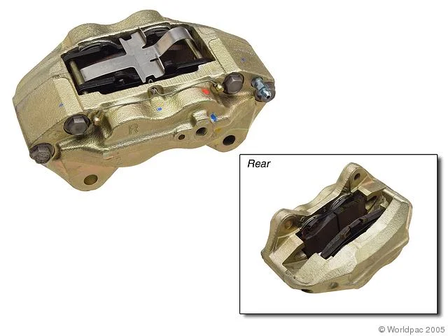

I think I need this caliper instead, this is also a Tacoma caliper
Has anyone used this set up before?

im not sure what caliper to use, but the brackets i had from ruff stuff had all kinds of issues.. I he sent me 2 new sets, they still are not right and my caliper is wearing wrong, the Squeek like hell when the get wet.. maybe their quality control is off or somthing.
It would make sense to use a caliper off a 2WD taco with the single piston, rather than the four. Cause four seems a bit overkill.
but your bottom pic is not one off a taco. it looks like a european caliper, like Mercedes or BMW.

The way I found these two calipers was to Goggle Tacoma rear caliper. I am not familiar with the Tacoma to know if these are correct.
Yea I thought the four piston would be overkill
