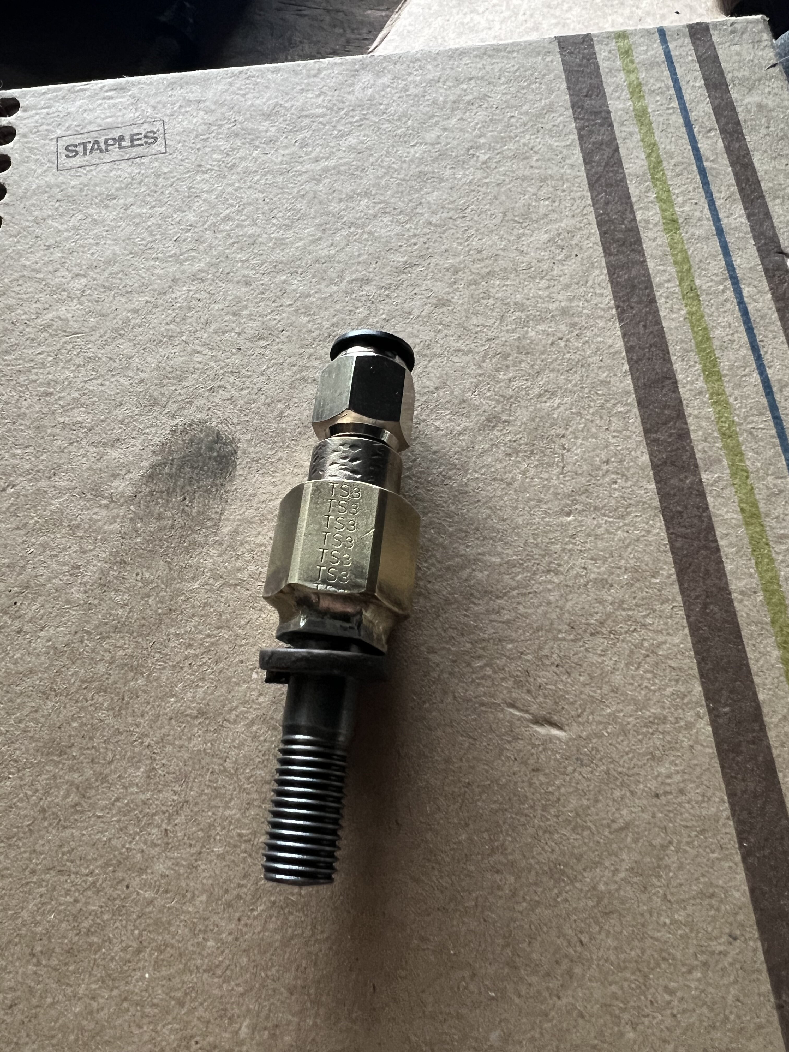

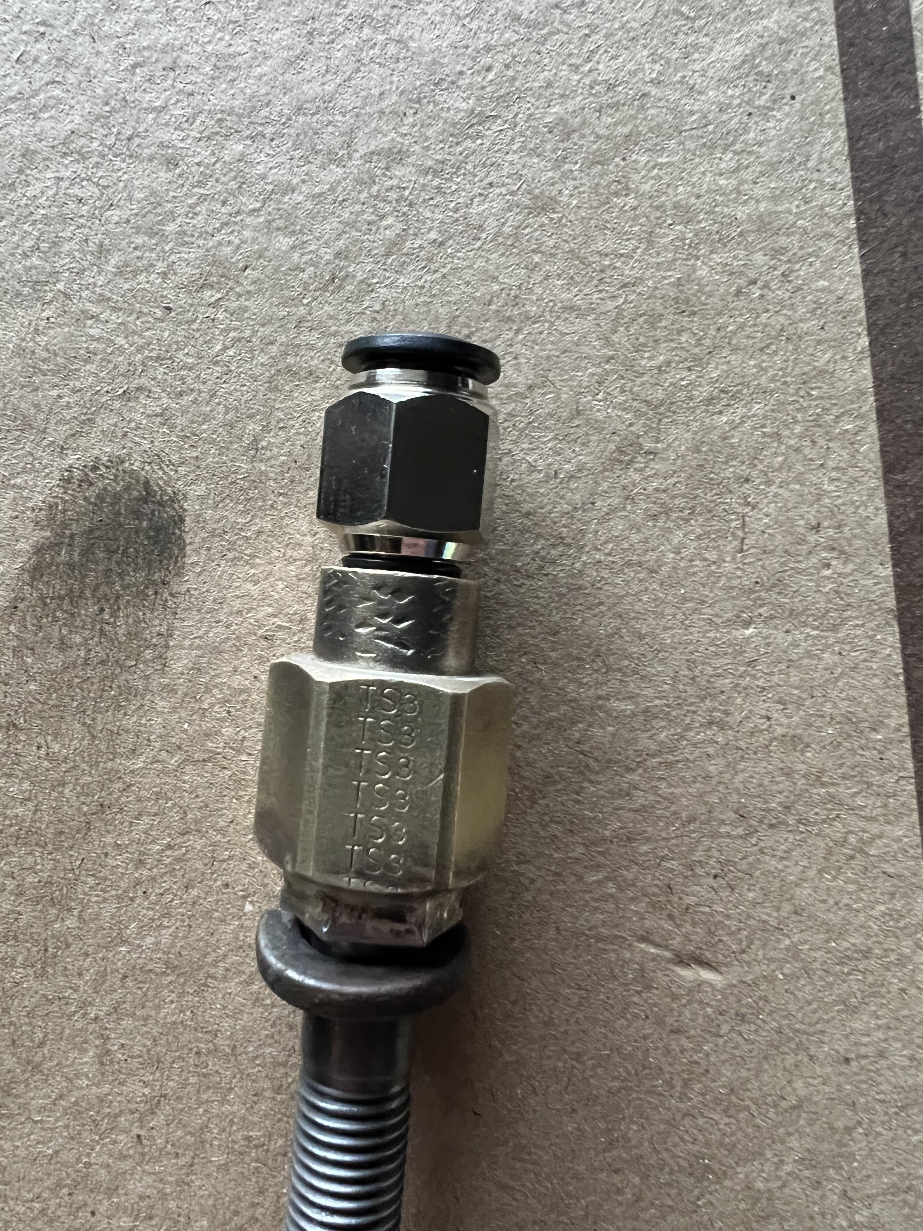

I used a 1/8" NPT (I believe) brass pipe nipple from McMaster... one end I used an air fitting and the other I cut down and threaded into the axle (not the same threads but had no issues with the brass) The shoulder of the air fitting severs to holt the "T" in place, you just need to make sure it's relatively close to the same length as the original breather so it snugs down. Good luck!

Take the cap off and weld a nut on the top of the breather
I should check and see if they're steel. I'm assuming they are.
That's an excellent solution if they are. Tig them together. Done.

A better breather setup would solve either scenario. The original setup isn't very good.
