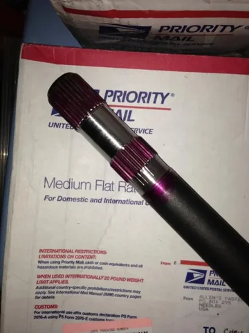

Have a potential cure for the twisted e locked crap on an 80, being an axle shaft with the splines machined off

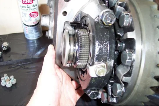

Remove the brackets holding the e-brake lines from the lower control arm and the frame in addition to the caliper hard brake lines on the axle housing. Then you only need to slide the axles out about 4" to clear the side bearings.
An empty 2.5gal water jug makes a good landing pad during the extraction.

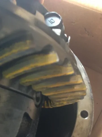

Ha-Ha! This was the 3rd time the factory 3.73's broke and I was planning to go to 4.56...so that's my UPGRADE happy face.
My .02 is, I also support the axle once slid out to take the weight off the seal. As you can see in that center pic. And I used a cut off wheel in a dremel to cut the top of the brake line tab, gives you a lot more room to move the caliper around once the line is out of that tab.

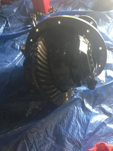

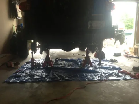

Ok, put everything back together, thinking it went to well.
Locked, dash light shows locked, shouldn't be locked.
Pulled old unlocked, pushed fork over to unlocked, and locker slid back in perfectly in the position.
Pulled unlocked
Reinstalled unlocked, yet she's locked.
Where'd I err?
Never mind.
I'm a dumbass.

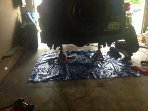

Way too long a day for brakes and third swap, but she's done.
Want a lift. I hate jack stands.

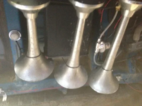

Kids. Probably the weight of his horns that caused the diff failure.
I guess.
More LEDs, be it interior or exterior, than a 747 cab.

Oddly, we never figured out what moved, be it the shift fork when installing third, or the locker moving once we slid it in.
Oh, well. Live and learn.
