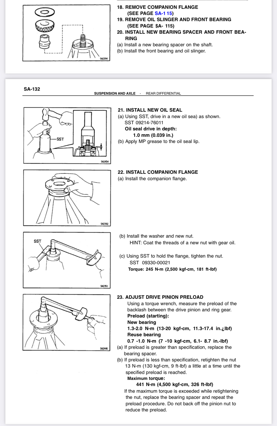

Hello, can someone provide me info for rear diff pinion nut torque? My LC80 is HDJ '91. I found file with info for other bolts etc on rear diff but no for pinion nut
Great. Thanks a lotThere is not really a specific torque spec. When you tighten the nut, you are crushing a crush sleeve and increasing the preload on the pinion bearings until the preload spec is achieved. The FSM spells out the procedure pretty well.
