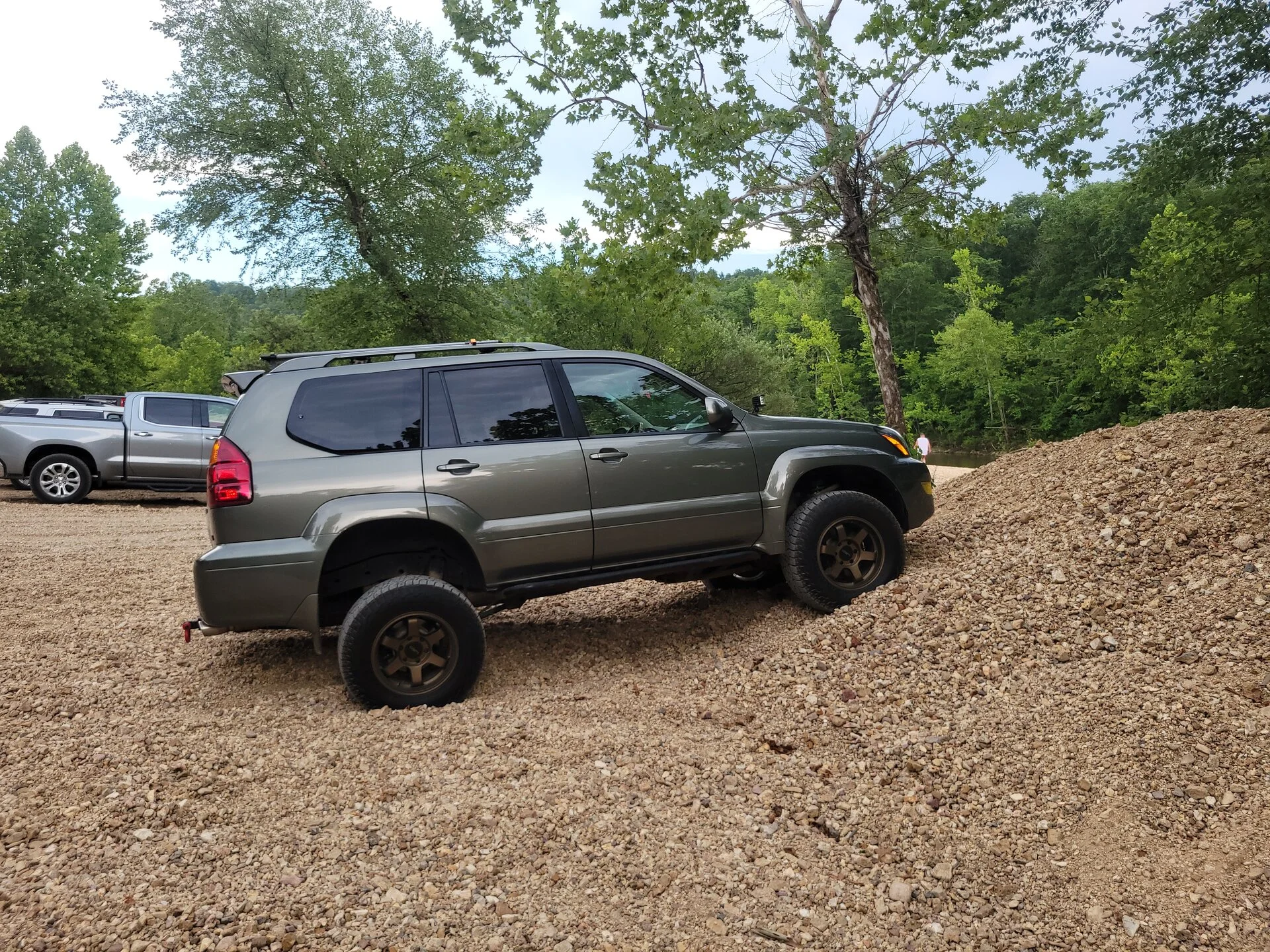

I have a 2.5" Ironman FCP rear lift and flex my GX out fairly often. It has 2" extended rear sway bar end links and DuroBumps bump stops. I've never had any clearance issues, but my setup is mid-travel and not long-travel. There are marks on the top of my axle from the bump stops hitting it - outside of wheeling I also tow and occasionally hit big whoops and land fairly hard, compressing the suspension.
EDIT: Photo below. My personal opinion is that the $370 you save would be better spent on a tune or onboard air :)
