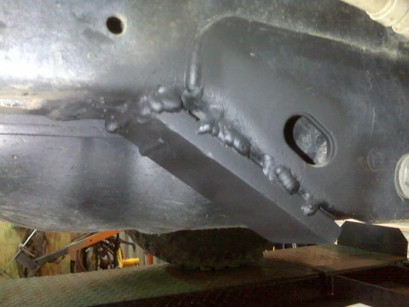

Rear control arm mount damage.

You can bend that back out as described above. Drop that end of the control arm and put a crescent wrench or flat jawed vise grips over the bent areas and twist them back into place. Sometimes a pry bar will work too.
Then get yourself some skids like the ones posted above and never worry about it again. :)
I mangled mine too, but we simply bent them back and welded some 1/4 steel pieces into a ramp over it as reinforcement and rock contact surface. Works great, but I recommend either getting the HD lower arms or reinforcing the stcok ones- the stockers bend pretty easy.
Are those solid (trailing arm tubes)? Looks like a good set up...I've scraped mine up, but no visible bends (yet).
Those and skids are my next weekend project. Those Rastas seem nice, but SOOO $$$. And I could see one good "thmp" cracking them...

This happened back in January... should I be overly concerned?
I don't want my FJ getting all wild and crazy while transporting the family around town.. nor do I want any surprises out on the trail.
What would be the best course of action for my damage at this point?
Thank you guy's I feel much better now. I guess I was just being a bit paranoid over something relatively little. I'll bend it out this weekend and I've already bought the 3/16 chunk ready to cut and weld over. If all goes well I'll be able to get the pix of that "build up" or Repair rather on the board by Monday. As far as CaliCaos it sounds to me like you're in about the same boat as me. Just bend em back and weld up a bit of reinforcement.

The All Pro's just cover the existing mounts. You do not use them to replace the damaged part. Just pull the control arm bolt, place the All Pro OVER the existing mount, then bolt it back up. Have a couple of ratchet straps on hand just in case the axle moves a little on you. If you already damaged the mount, start thinking about beefing up the LCA's as well! Mine had the snot bent out of them from just a mild rock crawling session.

my question is... does my bracket look like it needs to be replaced or covered or simply left alone at this time?
This is my daily driver, and I wheel it when the opportunity comes about. I am most time cautious.. but not afraid to try the difficult line now and then.
It doesn't look bad enough to replace. If the link is binding on the bent parts then bend them back and cover them with the AP covers or weld your own thicker piece of steel overlapping the bracket in a similar fashion. I got no welding skilz, so I bought the AP covers.
At the very least, scuff the rust off and spraypaint them black again to prevent rust from affecting the integrity.

Here is my "temp fix" for my rear control arms. My welder was acting up, I think I was over using the duty cycle finishing my skid plates. Yet again I digress, here is a picture of my new "light" armor for the driver side control arm mount. :)
Thanks, there is plenty of penetration so they are solid they just look like heck. I'm not too fond of using a buz box, especially when I'm under what I'm welding.
