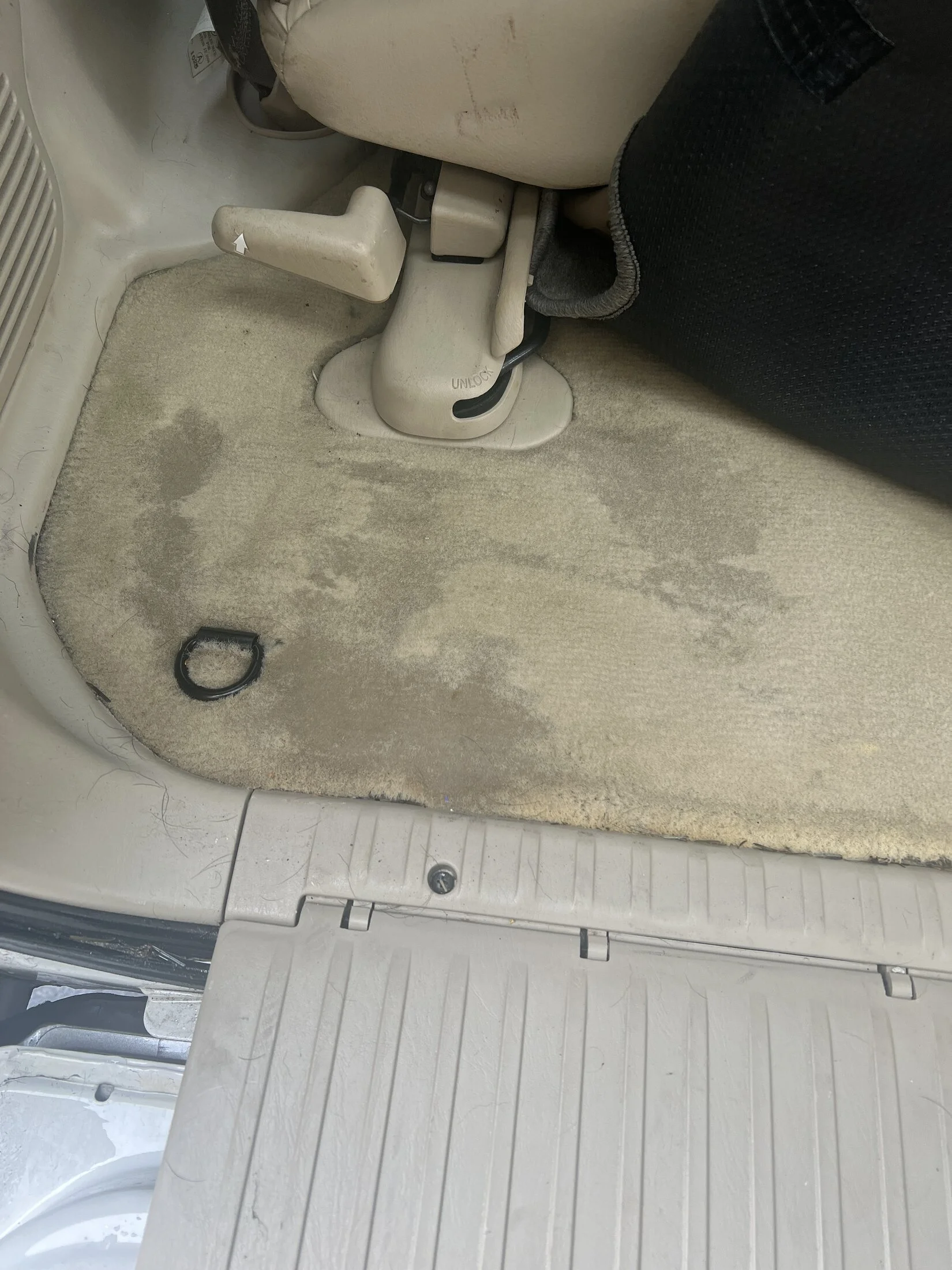

South Florida has been having some heavy storms for a few days now. I got in this morning and noticed a musty smell, looked around and noticed this wet spot on the cargo area. Any idea where the leak is? I park in the garage 99% of the time so first time I am seeing this
Most likely - 3rd brake light, followed by rear gate harness boot against gate hatch metal. If that's the case, replace the third brake light and use a bead of butyl on the top side to seal properly. Less likely (still quite possible) - your roof rack anchors have lost their water seal, and need to be resealed w/waterproof window/door caulking. I've had all these issues and these solutions have worked.

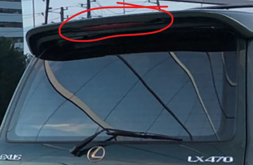

My cargo area is soaked after a rain in Houston this weekend, rained again today and I see water dripping from inside center plastic trim over back window, and down both sides of the inside trim inside the tailgate. My brake light is on the air dam spoiler thing, if it is leaking I don't know how it would get where the water is. Is everyone's brake light on this spoiler thing or directly in the hatch top?
Since you have the spoiler with the integrated brake light then chances are your leak is coming from the cover blank on the upper hatch. It's plastic and paint matched. You'll see it when you get up at roof level behind the spoiler. Remove the blank, clean the old gasket and seal it up again.

I found the original light, it is nested under the spoiler thing. l'll have to figure out how to get it loose, it doesnt have screws on the outside. How do I get it out?
just from memory so I may be off a bit but:
Open rear hatch, remove the plastic trim around the window. couple rubber caps to pop out at the top... Then look inside and undo the 2 nuts....10mm IIRC.
