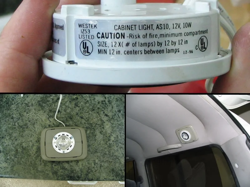

I have been wanting to improve the cargo area lighting in my 80. I have read all the threads and didn't find exactly what I was looking for. A few weeks ago while looking through my basement I found a set of low voltage lights designed to fit under cabinets. These are 12 volt/10 watt lights that use a transformer when run off household current. At a glance they appeared to be about the same size as opening for the cargo area speakers.

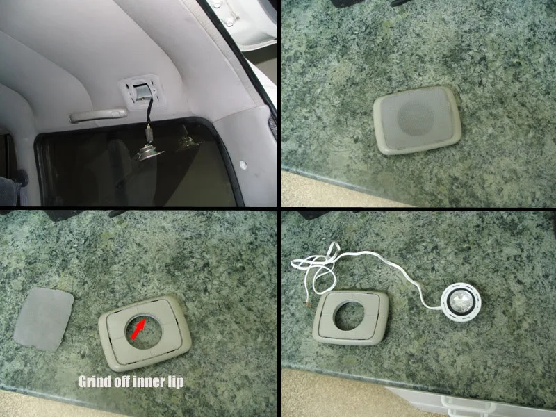

I pulled the cover off and discovered that except for a tiny lip the lights would slip into the cover nice and snug.
First step: pull the cover and remove the grill by bending the tabs on the backside. (I'm sure you could leave the grill and cut it out to fit the lights if desired)
Next using a dremel style tool or lots of elbow grease remove the lip inside the cover.
Push the light into the cover and fasten with screws.

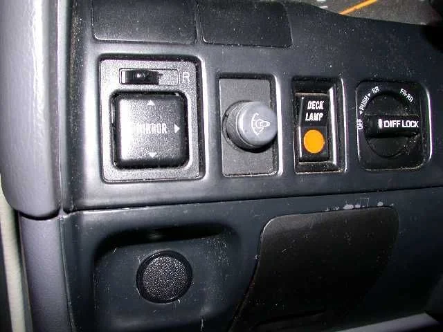

I ran the wiring down the rear pillar and used power that I had already run to power my subwoofer. I chose to put the switch inside the old ashtray holder to prevent accidental activation. They are very bright and do a great job!

No sorry I was looking through a box of electrical parts and found them loose. I was sure somebody would ask so I posted the pic with the label exposed...I was hoping that would help.
Go look at Home Depot or Lowes, I know they sell similar stuff and Im almost willing to bet they are the same size. Just make sure to get the low voltage versions!!

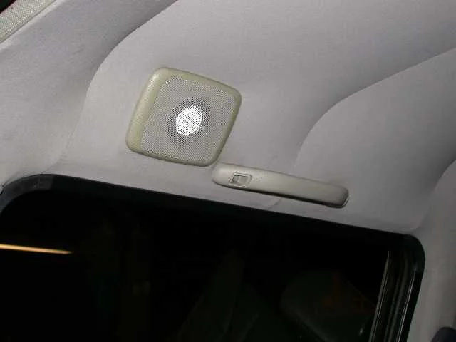

Here is a pic from tonight to give a little better idea of the LED in the rear. The pic is untouched as far as the brightness.

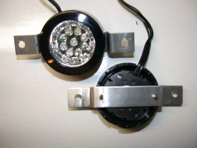

Thanks for starting this thread. Had to go out and buy some LEDs too. Install is a little different. Made some brackets to replace the speakers. This way the lights are behind the speaker grille for that stealthy look. Used a rear deck light switch from a 85 4-runner. :beer:
