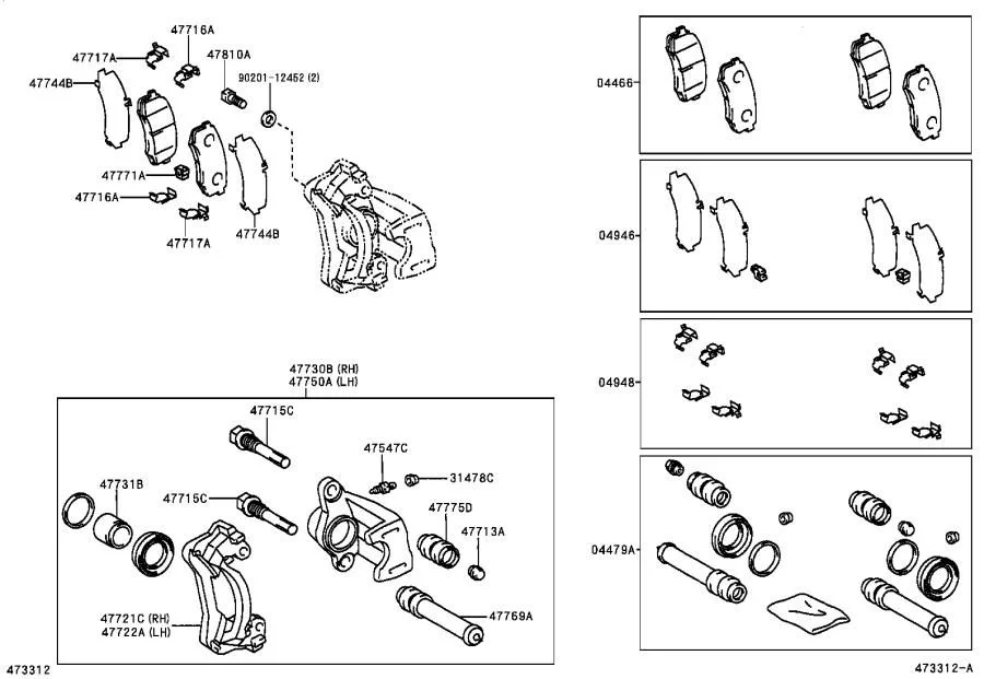

I have an 06' GX with a little over 150k miles. I started hearing some squealing from the back right and narrowed it down to the brakes. I changed the fronts a few weeks ago without any issues with EBC green stuff pads and rotors (happy so far). The pads on the right were almost bare and the rear left had about 3mm or so left. The rotors were a little shabby so I changed them out as well also with EBC green stuff pads and rotos. The left came off without any issues and everything bolted up nicely. The right came off easily as well but when I went to put the slide pins back in, the top slide cylinder pushed out the rubber grommet and twisted. It was considerably harder to put in as opposed to the left side and it felt harder to move. In hindsight, the right pins were harder to pull out and I wonder if they were somewhat seized.
I presume that's why the rear right pads were so much more worn than the left side. That in mind, can I just change the slide cylinder and new slide pins (~$40 total) or is the recommendation to just buy the new caliper from Lexus (~$200). Also, I noticed the rear left caliper had already been replaced, not sure if that factors into it, but my GX is my daily and I don't want to put too many miles on it if I need to change a single brake.
In the Pic, the pin I'm referring to is 47715C and the slide cylinder is 47769A

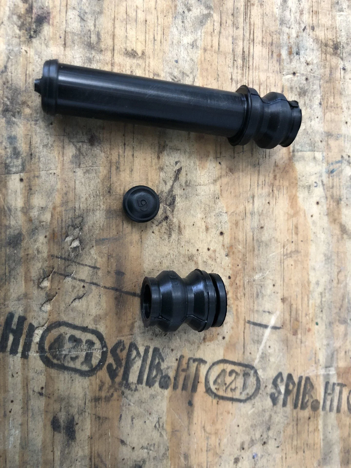

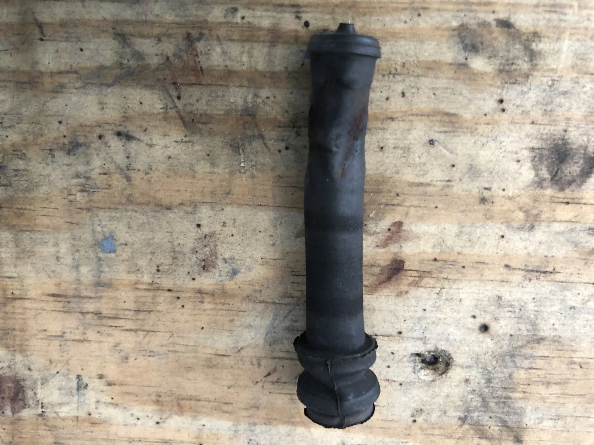

Conveniently Lexus has a 15% off sale through select dealers so replacement pins, and boots were a collective $10. Replacement was easy. I pulled out the bottom boot out with ease and the boot was kinked with a little hole, which explains the lack of grease on that pin. I used the back end of a drill bit and put some antiseize around the outside of the new boot to get it to slide better, and it went in fairly easily. As for the top, its 2 separate pieces that both snap into place without much issue. I put the lithium grease in each tube, put the caliper back on and bolted to 65 ft-lbs. the bolts still didn't slide in nearly as easily as the left side did/does. In particular its the lower pin. I still need to get a brake fluid flush but Either way, its fixed for now. Next brake change I think I’m going to get new calipers but hopefully thats many many miles down the road.
In hindsight i should have taken a wire brush to the inside of the lower tube, maybe that would have opened up the diameter enough to get the pin to slide better...
