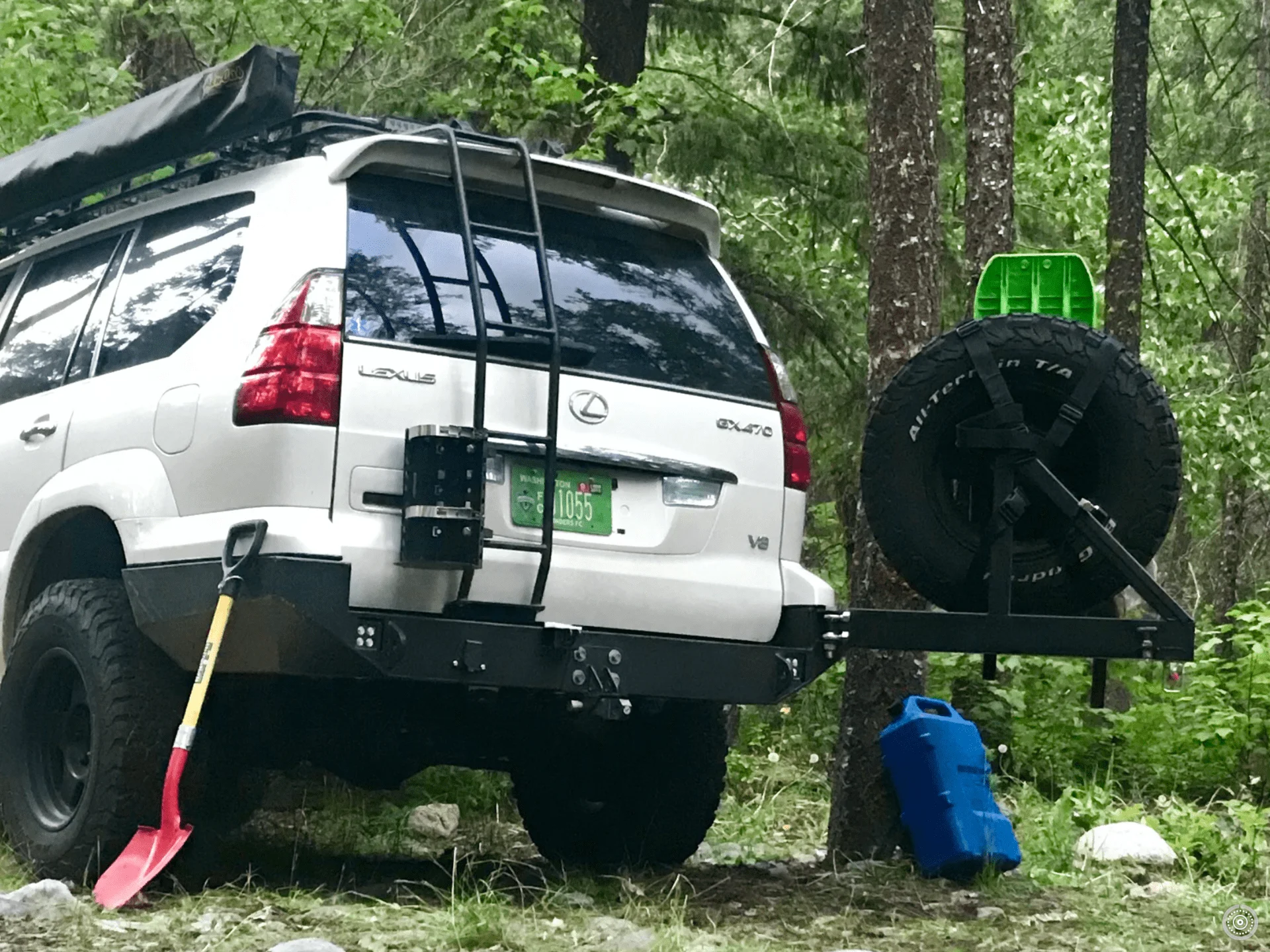

I just finished my Coastal Offroad rear bumper this week and originally, I was going to tap the reverse light power from the tow plug. But, I think I would rather have these lights on a switch independent of the reverse lights. I was thinking I would put a swtich in the hole left by the rear suspension controls. What have you guys done for this?
