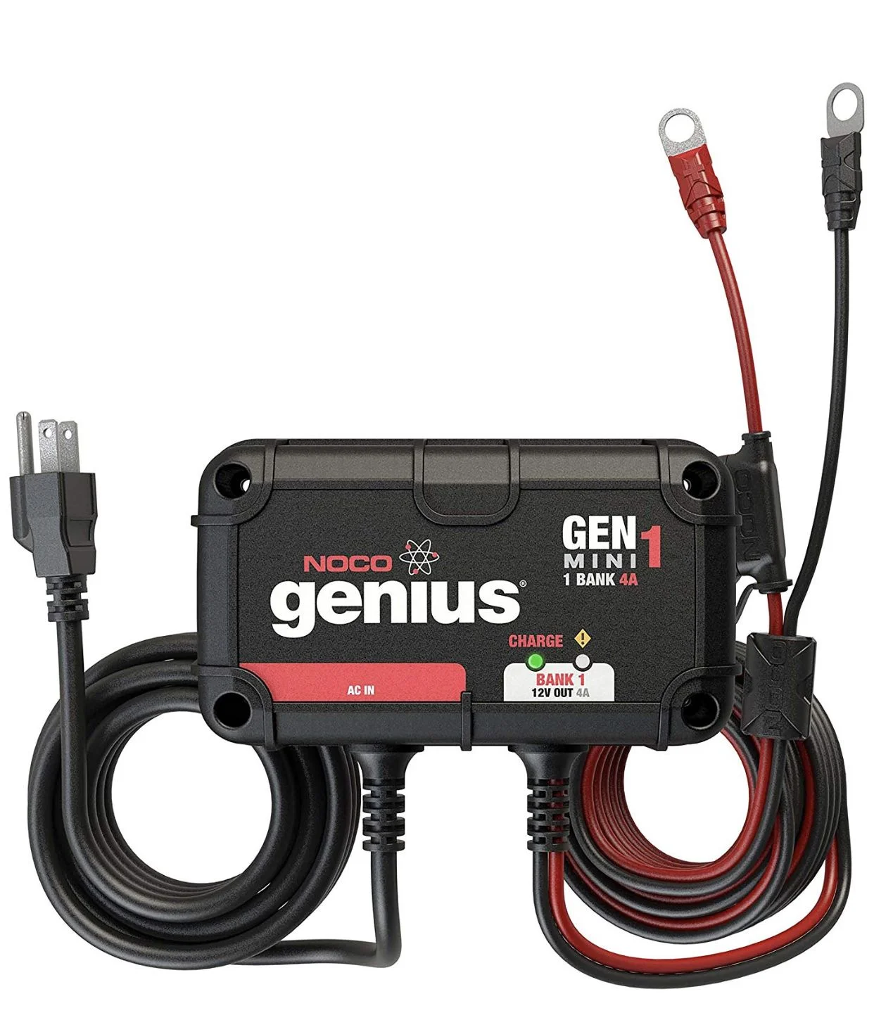

I’m putting together a quick power supply for a Dometic 75 cfx in my 200. My plan is to dual battery later this summer. But for now going to just use a group 35 agm in a battery box in the back. Will run solar during the day and hoping to run a small charger off the rear 3 prong 120 ac plug to help charge the battery while driving.
My question is: will this even work? Limited info found on the draw of the charger itself and the max output of the plug. Combined with my limited electrical knowledge I’m kinda stuck.

I believe your plan can work depending on some details.
Specifically to your question about that particular charger. Looks like its output is rated for 12V @ 4amps, or approximately (12*4) 48W output. Conversions are not perfect so expect the input draw to be incrementally higher. I know the rear 120V output is rated at 120W, which should give you enough overhead. The amazon comments are a bit confusing as they talk about 10amp output? Which would indeed be much closer (12*10=120W) or possibly over the rated 120V output.

So it seems that there are very limited 6amp chargers out there. I have found two 7.2amp chargers (CTEK and NOCO).
7.2*12=86 watt draw (+a little more for the conversion) Pretty sure the cover on the LC plug says 100 watts, not 120. Do you think this would be a safe call?
Ah, thanks for the correction. 100W it is.
I'd be comfortable that an 86watt charger would work. The 100W rated inverter probably has some slight margin/headroom within its rating too.
