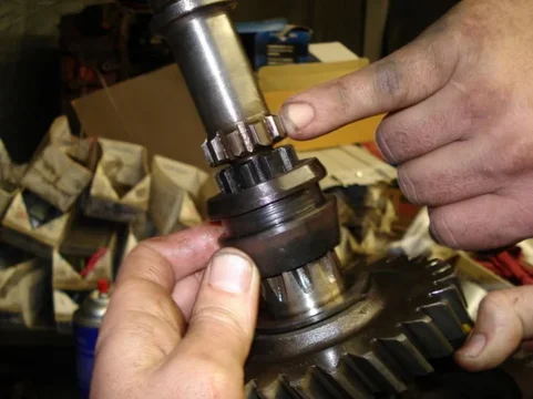

3spd front output is what I need, unless someone can tell me that a 4spd tcase front output is interchangeable with a 3spd. :D
I talked to Justin earlier, he's bringing one from Colo. Spgs tomorrow night. Kurt W. is sending one down from SLC tomorrow night as well. If I can get one tonight or tomorrow morning, early enough, we can wheel tomorrow and Thur. ;)
A four speed transfer case prior to 04/75 would be compatible, so effectively, no, they are not compatible, as the coupler and output shaft splines on the three-speed transfer case are coarse spline and not fine spline, like the 04/75 and later front output shaft and front drive coupler.
Pics originally posted by Manny....
Three-speed and 03/75 and earlier 4spd transfer case style:
04/75 and later four-speed style:
