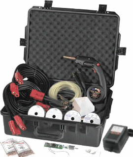

Two group 31 batteries will push .030 flux wire through 3/8" steel NO PROBLEM.

But aluminum wire is relatively soft and fragile. It doesn't feed very reliably through a lined feed to a mig gun. (the only way I could get it through was to lay out the welder gun line straight and even and even then the feedroller gouged and messed up the wire) So I put a roll of aluminum wire in the ready welder and hooked it up to three batteries for my occasional aluminum need. It works great for that, and all those batteries had no problem generating enough juice for the amp eating aluminum.

The Model #10000 will also connect to most MIG/CV (constant voltage) machines and all DC output-welding machines. This model will run off any 12, 8, 24 & 36 volt batteries in a parallel series depending on the application and material to be welded.
This model is identical to our Model #10000 except it includes our AC to DC Power Converter to supply 24 DC voltage to the RWII circuitry…used only when connecting to CC (constant current) Stick welding machines. Since there is more Stick welding machines in the market place than any other welder, the ADP could be the perfect buy for those that like the ability to connect to all DC output
welding machines.
