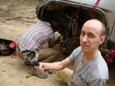

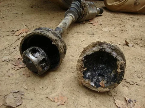

I've changed a handful of CV's on my FJC. I am still of the opinion that I'd rather change a CV than a diff on the trail, so I carry a CV in my spares kit. I will also add that while a CV axle can be obtained from Napa/Advance/OReilly's for about $100 - it is a far inferior product compared to factory/OEM axles. My first (and last) "cheap" CV was branded "FEQ" and didn't last through one wheeling trip. The spare I installed on the side of the trail was an older Toyota CV that was not 100%, but it got me off the trail and home just fine. So my word of caution is that if you go cheap, don't expect to wheel it. It might be fine on the pavement or light action in 4H, but I wouldn't trust it beyond that. Stick with factory parts (or reputable off road brands) when it comes to the CV's.
Oh and as Lee said, with a little practice and maybe and extra set of hands, you can do this in 20 minutes. Here we are with the cheap CV on the side of the trail.
