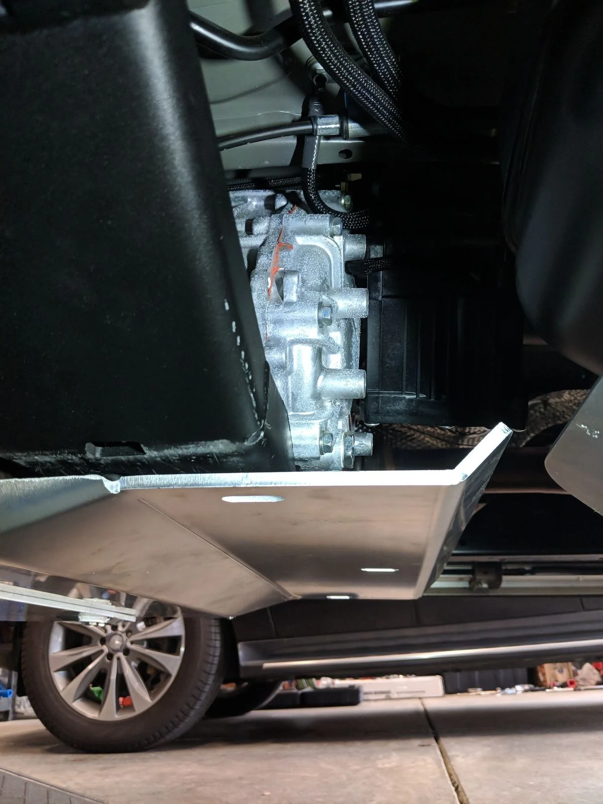

This is what I have listed on my build (His and Her GX 460 Builds):
***Cheat sheet note: For GX 460, although most RCI 5th Gen 4Runner skids work (front, engine, gas tank and LCA skids), the transmission and transfer case skids should come from a 4th Gen V8 T4R. The cross brace for the transfer case skid should be from a 5th Gen T4R, and will have to be modified. The vertical wings on the transfer case skid will also need to be trimmed a little to fit.***
Note that I used the 4th gen transmission skid, different from HitchCrack. So definitely ask RCI for clarification. And make sure the cross brace that connects to the frame rails is from a 5th gen, because a 4th gen is for the 120 platform and has a different frame.
I have some photos and info starting on the bottom of the 2nd page, but also some updates and clarifications with photos in the next few pages of the thread as people asked questions.

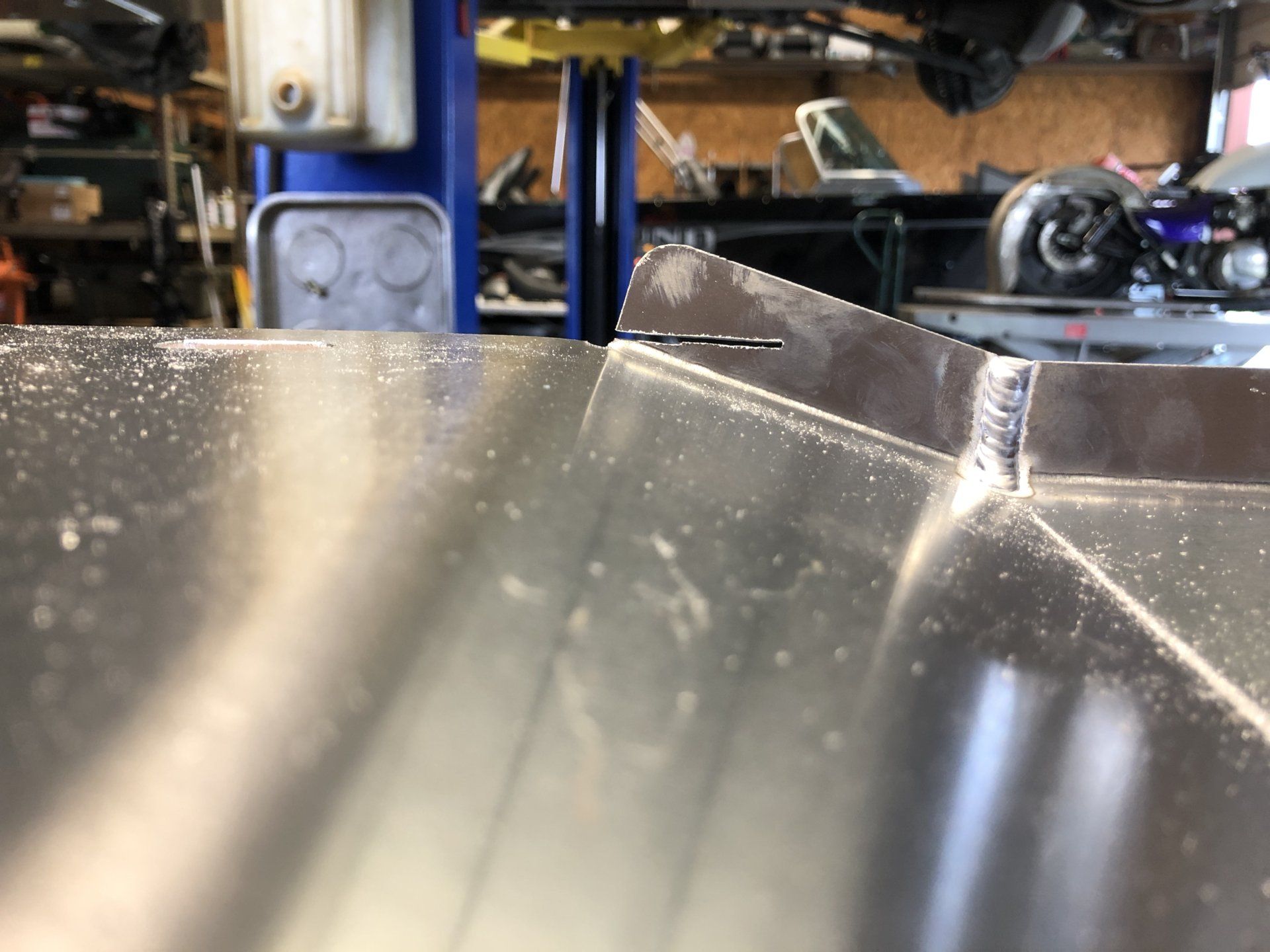

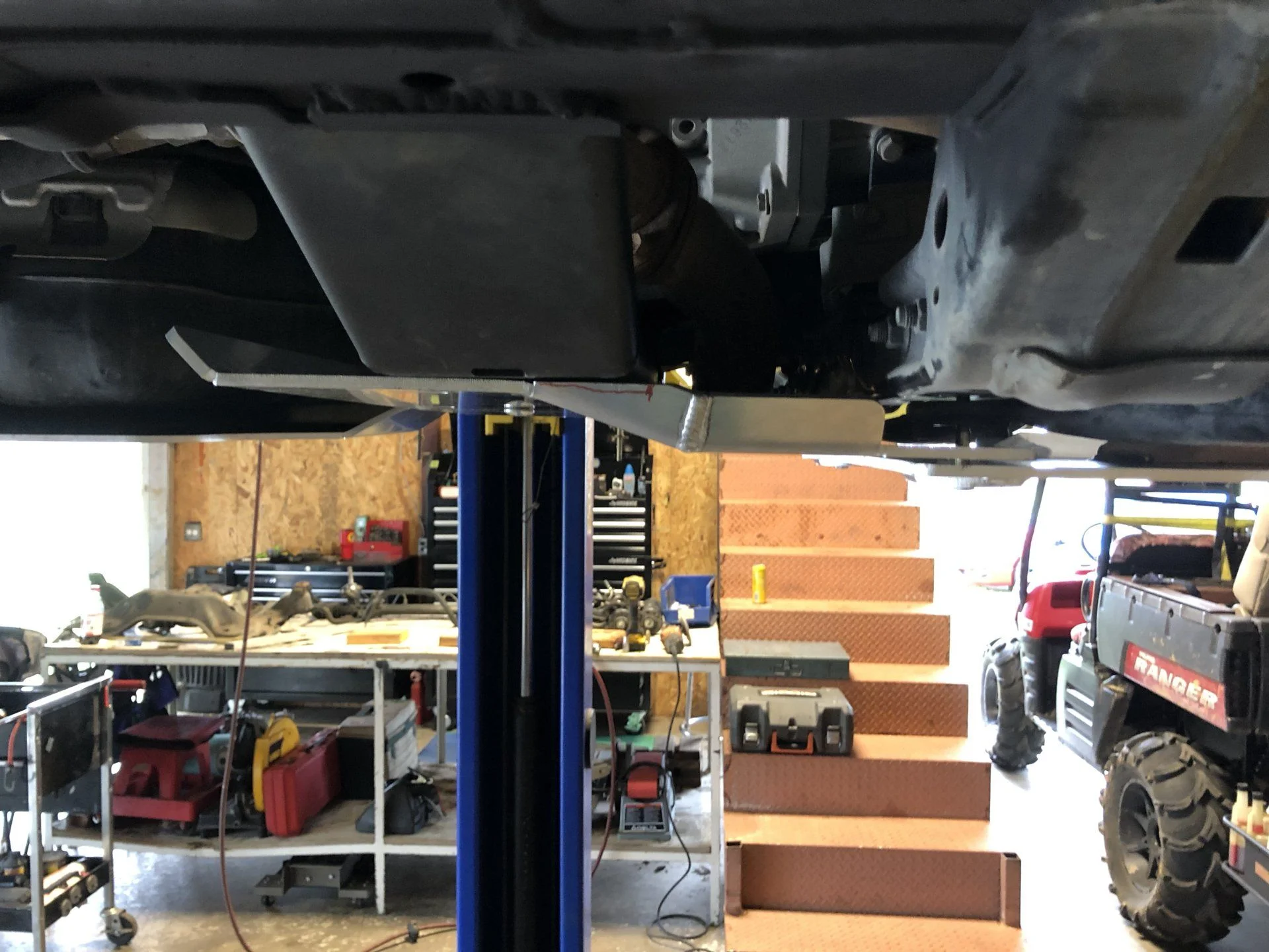

@HitchCrack @TX GX460 did either of you guys drill new holes in the transfer case skid or crossmember for the bolts? For obvious reasons, my 4th Gen skid is no where close to bolting up with the 5th Gen crossmember. Assuming RCI sent me the correct parts...the cross member definitely bolts up without issue (after notching it for the t-case) so I assume they did.
EDIT: Drilled 2 new holes in the crossmember on the outboard holes...easy peasy.
TX GX460, I found in your build thread where you said you drilled a couple holes in the crossmember and Hitchcrack, it looks like holes are getting drilled in your crossmember in one of your skid album pics. Guess I was on the right track.
