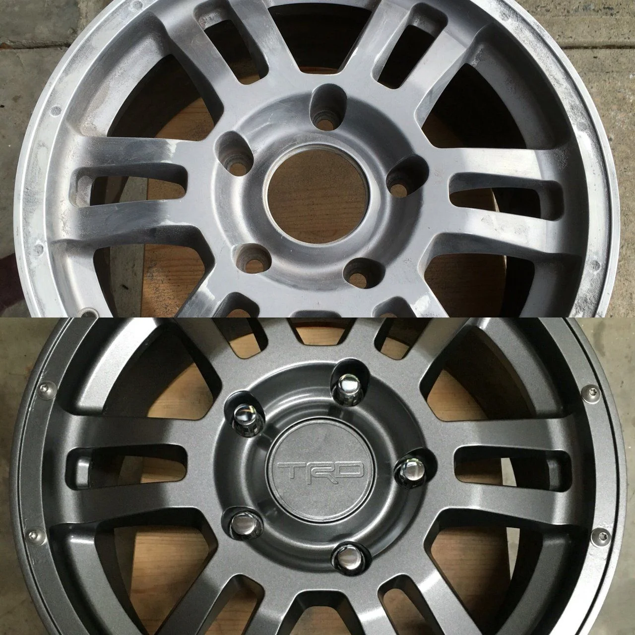

I recently picked a set of four 2014 Tundra wheels (pictured below) and looking to paint them gunmetal/anthracite in a matte or satin finish. They're cherry with less than 2k miles on them. No damage or defects. They're completely stock with what looks to be silver paint and clearcoat?
I'm aware of the sanding, acetone, scraping methods of removing paint, though I'm unsure if all this would be necessary for my circumstances and desired result. It's my understanding that if I'm looking to just rattle can wheels that are already in great shape that I just need to scuff it up enough for the paint/primer to stick? Do I really need (or is it strongly advised) to strip it down to bare metal? Not looking to spend a lot of money on kit to achieve the look I'm going for, nor do I want to powdercoat or plasti-dip. Rig will see many off-road miles. I'm willing to put in the work, but the tales of 5+ hours per wheel sounds tedious.

Desired result would be something like what Paul achieved:
Well I had access to a big sand blast room so I went that route but my rims were old and had a bad paint job to start with.
In your case I would just scuff the surface with a scotch brite pad I would use like the purple colored one or if you have sand paper already I would say something in the 600-1200 grit the higher the better. Make sure and get all the nooks and crannies. Then hit it with some acetone or rubbing alcohol a couple of light coats of self etching primer then use the rattle can of your choice. I chose the same as a lot of members and went with duplicolor rim paint in graphite. If you know what color you want I recommend paint over plastidip just because its more durable and touching up scratches is simple. I also avoided a top coat of satin or gloss to make touch ups easy.

If the finish is good on the wheels you have then all you really need to do is scuff them up with a red scotch brite pad to give the paint something to bite too. IF the wheels have some oxidation on them from being in the salt and brine then I would sand out all the oxidation spots with 120 or 180 paper first and then hit the whole wheel with the scotch brite pad. The sanding is the worst part and most time consuming BUT it makes the most difference in the end result.
Once you are done sanding wash all the dust and grim from the wheel faces with soap and water. Sit the wheels out in the sun or in a heated garage and let them FULLY dry. You don't want any water mixing with your paint.
Once the wheels are dry wipe them down with rubbing alcohol and gloves one last time before spraying.
I'll pause here to talk about priming. I've primed and not primed before spraying and honestly the priming is a waste of time and $$ if you are using the actual wheel paint from Duplicolor or VHT. The wheel paint is very forgiving so I see no need to prime if you have done a good job prepping the surface. I will say that there is a slight difference between the Duplicolor Graphite and the VHT Graphite finishes. The Duplicolor has a metallic finish as there's metal flake in it whereas the VHT has more of a flat or matte finish. Personally I like the Duplicolor finish better.
When you get ready to spray sit the wheel on a angle at 45* or so. This way you can always keep the spray can upright. Shake the can very well and if it's cold out I even sit my cans in the house for a few hours prior to spraying so they warm up. Once you start spraying apply several light coats across the wheel until it's completely covered. Let it sit for 5 mins and then apply a few heavy coats and your done.
I then let the wheels dry for 24 hrs or more before mounting tires so the finish is fully cured.
You can get great results if you take your time and be patient. It's durable as well and if you hit them off-roading it's an easy touch up which you can't do with a powder coated wheel.
Hope that helps!
This is a set of Tundra wheels I just did with Duplicolor Graphite.

Steelman, I really like the results you achieved there. I'm heavily considering yours and Scubajon's advice on the scotchbrite pad and Duplicolor wheel paint. Reassuring to know that I can just scuff up the wheels thoroughly and layer with light coats :D
