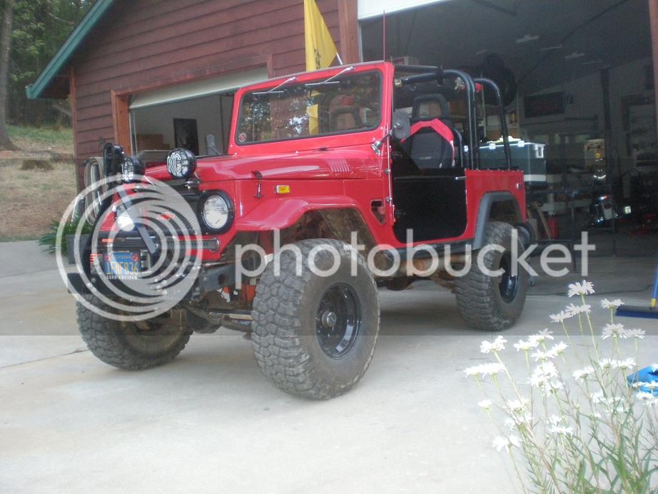

I needed to re-paint my custom half doors and paint shop was too expensive. Went to the paint store to inquire about purchasing the paint I needed to use with my air sprayer gun. That came out to $145. SO I said screw it and decided to go rattle can for $29 complete. I sanded the doors and scuffed them, painted on three coats of primer with sanding in between, then applied Duplicolor semi gloss black with three coats, then three Duplicolor clear coats. Came out awesome. Hopefully it holds up ok.
