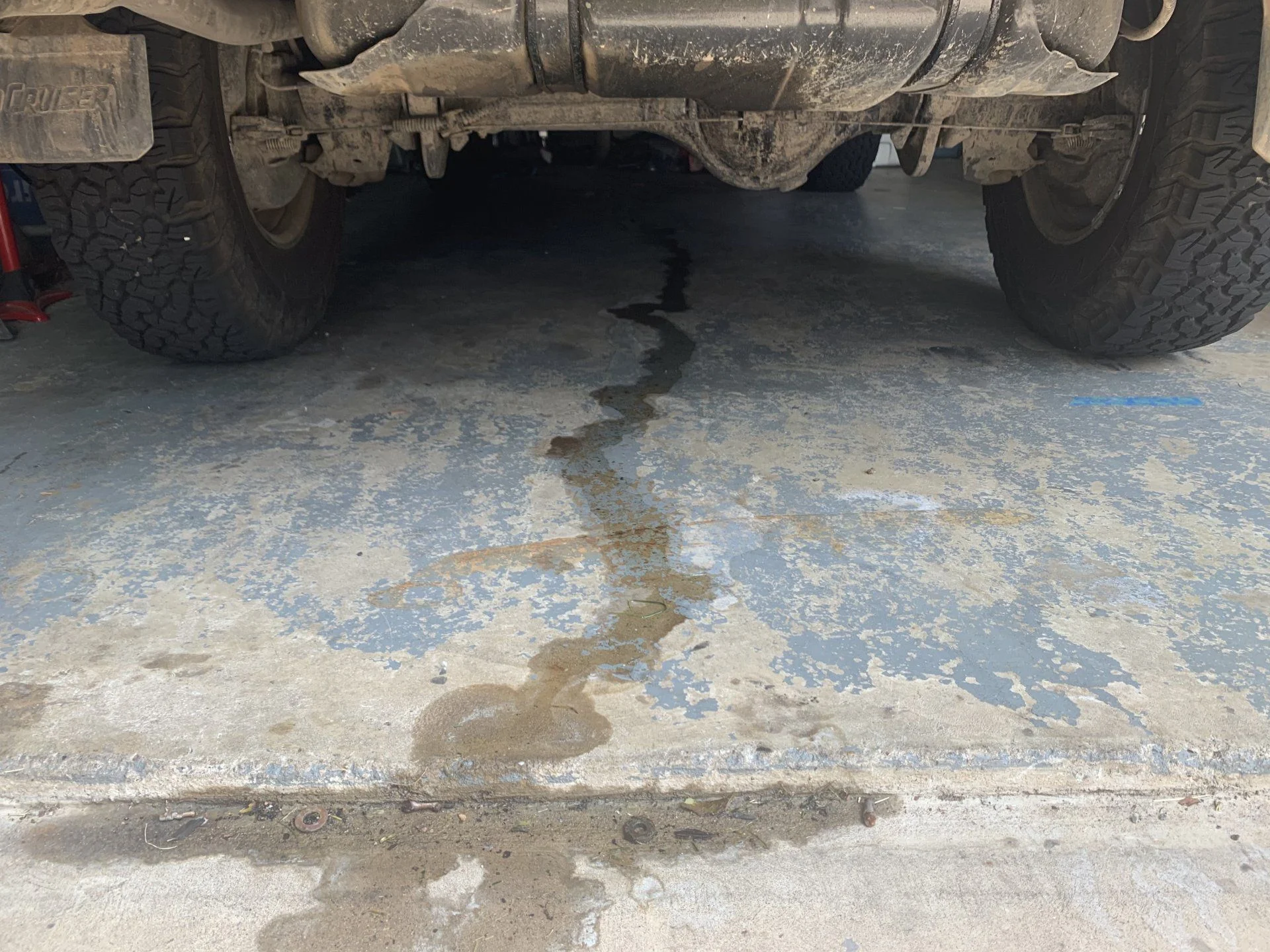

I have a 1994 KZJ71 JDM with the 1KZ-TE. I will replace the water pump soon due to the impressive coolant river headwaters formed from current water pump.
While I'm in there, I'd like to replace the OEM radiator (OEM part number 1640067020 ) Does anyone have a suggestion for replacement radiator? I hate to drop over 600 for a radiator if there are good alternatives
River of coolant for good measure:
