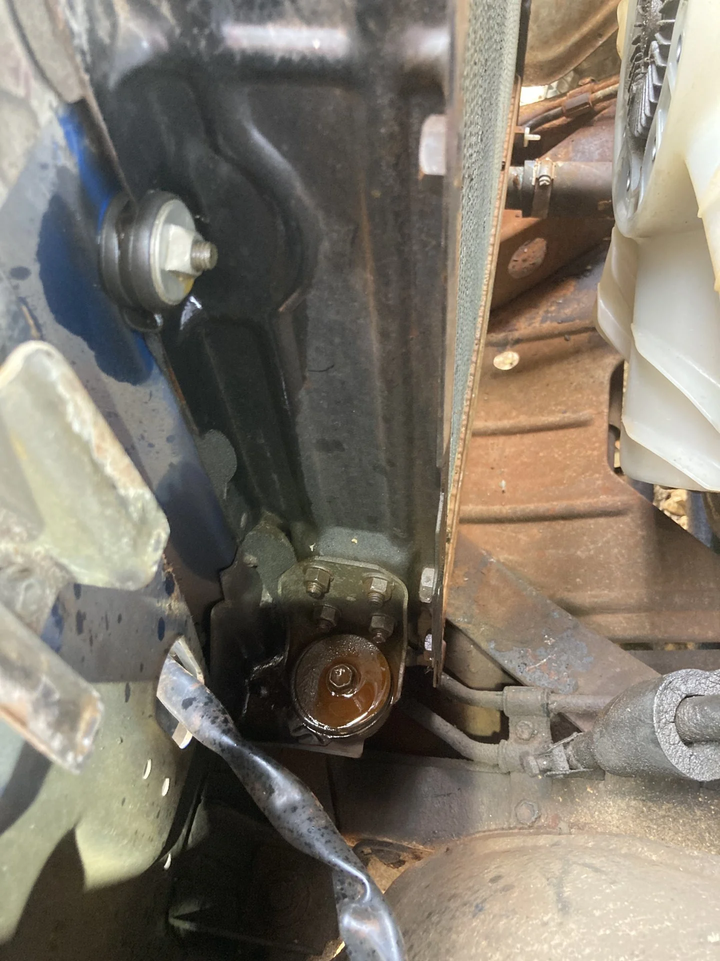

Is the top square nut on a stud or am I going to have to loosen the condenser to get to the back of the bolt? Thanks-
you need to remove the bolt from the front side, I usually take the condensor loose and let drop down and have access to the bolt heads
Thanks- I was able to break the nuts free and was hoping they were on studs- it would be a simple radiator exchange if they were- I had my shroud cut in half when the water pump was replaced so it was easy access to everything once I removed battery and tray. If everything was laid out and drained it wouldn't take an hour- Was just prepping today- swapping it out tomorrow.. thx
