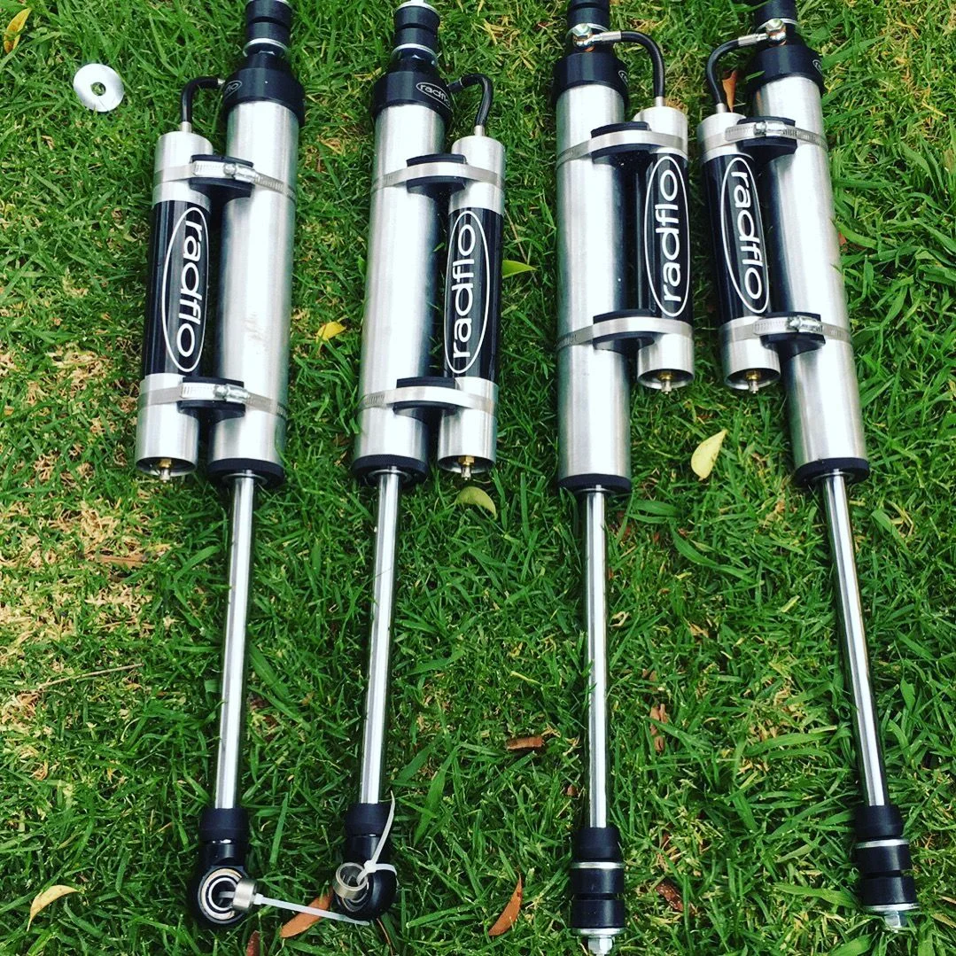

Whos here is running radflo shocks? After adding a lot of weight to the back of my 80 I'm looking at adjusting the pressure and or valving ?
Rear axle has 1564kg on it.
Front axle has 1300kg on it.
Complete weight is 2864kg running efs 4 inch 400kg constant load coils.

You are going to have to re-valve the shocks to control the extra spring rate and weight of your vehicle. This may require an increase in the gas pressure to handle the stiffer valving.

You are going to kill those shocks in the front! Ask me and I might tell you why!...hours and hours of testing them, I found the culprit of why I went through OME shocks and other shocks as well!
shock is a shock, just want to get the most accessible shocks you can. I just stick with KINGS since they are local and they stand behind their products! Look at the products that are or will be available for the 80s
How am I going to kill them then ?
Run your shocks for a 20-40 minutes and touch the shock body! Report back to us what the temp of the shock body and res are
I would kill the OME shock about 6 hours into my Death Valley trip and I had it replaced under warranty 3 times,once after each trip and arb would no longer warranty them as I was using the shock as not intended
Also having the piggy back res will create issues down the line for both front hand back! Seems Donahoe people aren't putting the time nor the effort into the 80 kits! One kit has the front resi cantilevered on the front so that the res will vibrate and having the res in the rear mounted along the body of the shock will and might be a chance that you damage the res body when you bottom out!

Like I had stated before! Go run your truck for 30-40 minutes and check the temp on the shock body and res! Tell us what temp they are at!
Then we can try and solve the issue!
I'm beginning to get the hint that temperature might have something to do with it. Just a wild guess,I could be wrong though.
Yes sir! You sir are a genius! Whole point of having a res shock is to keep it running cooler! Heat kills the oil in the shock and after an extended amount of use, causes fading!

I'd go with some flavor of 2.0 resi and talk to your good local shops or the manufacturer about having them valved. Most will valve them for free based on some info from you. That'll get you into the ball park. Close enough to probably not worry about fine tuning on something like an 80 series.
BUT, you might actually have to do some measuring and some flexing and maybe even make custom mounts. Heaven forbid. Make sure your high dollar shocks aren't the bump stop.
Theres nothing wrong with remote or piggyback shocks if you actually spend time and test everything. Resi's work well for this prolonged high speed rough terrain s*** you guys are talking about. Your standard emulsion shock mixes nitrogen with the oil and this aerates your oil and decreases damping. Your resis keep the oil and nitrogen separate so you're much less prone to shock fade, and the damping is much more consistent. They also help with cooling which helps with shock fade.
Personally I don't think anyone here is going to push an 80 series hard enough to need 2.5 resis and you'd be better off with a 2.0 resi than a 2.5 emulsion, IMO.
