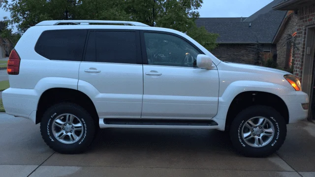

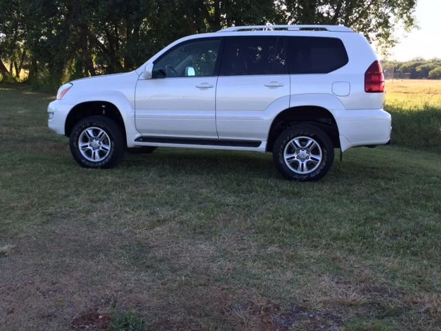

The install went smoothly - No problems. A few new squeaks that I haven't been able to run down yet (probably the sway bar), but no thunks or clunks. I got about 3.5" in the front and about 2.5" in the rear. The pictures do not do it justice.
New tires will be coming soon!
I gained 1.25" of droop over stock and currently have 2.5" of down travel. Was hoping for more but still pleased.
Will post pics once tires and mounted!

Definitely more truck-like, which is what I wanted. At times the ride of the GX was more boat-like.
As far as dampening, it is slightly more stiff than the stiffest selection on the ride control. I could get better ride if I backed off on the ride height, but I like the stance currently. I don't plan to lower it unless it starts to make unusual noises (i can live with a little squeaking, which I am still trying to address).
Went with 285/70/17 BFG ATs.
A little trimming behind the front tires and moved the fender liner forward of the front tires. No trimming in the rear. Fronts rub on the sway bar and frame at full lock, but not too bad.
It is tight on clearance around the upper control arm, but no rubbing.
