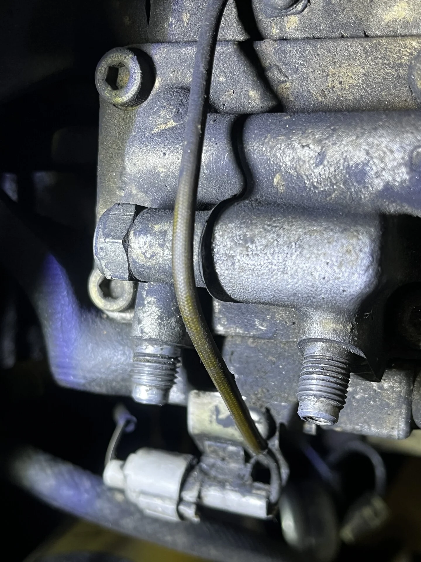

I’m in same boat on my 1992 FJ80. The universal adapter kit fits on the low side (picture left port), but the high side (picture right port) r12 port on the compressor is smaller diameter and tighter thread. Both of the universal adapter fittings are too large for the high side port on the compressor.
Does anyone know where we can purchase a 134a adapter fitting for this smaller high side port?

One more question I’m ashamed to ask. I can’t convince myself which port is the high and which is the low. The suction and liquid lines come into a manifold on top of compressor that makes it look like either port could be high or low.
Based on the picture above (1992 3FE FJ80), which side is HIGH side: left (closer to engine block) or right (farther from engine block)?
