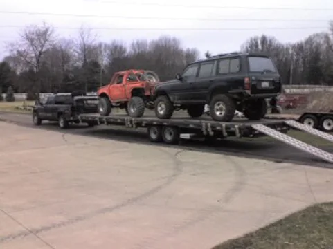

This is how I am getting my 80 and my mini to the trails this year. Last year I used a 20' gooseneck to pull it. A duramax powered 3/4 will pull a 80 just fine. The gooseneck trailer is safer and smother than a bumper pull trailer. goose_newA(1).webp
That is sexy Kirk!
I had a 24' fifth that would have been perfect but storage became an issue and she had to go. Oh well...
Where did you pick up the 20' gooseneck? They are not nearly as common in CA as in the mid west it seems (I have family in the mid west).
