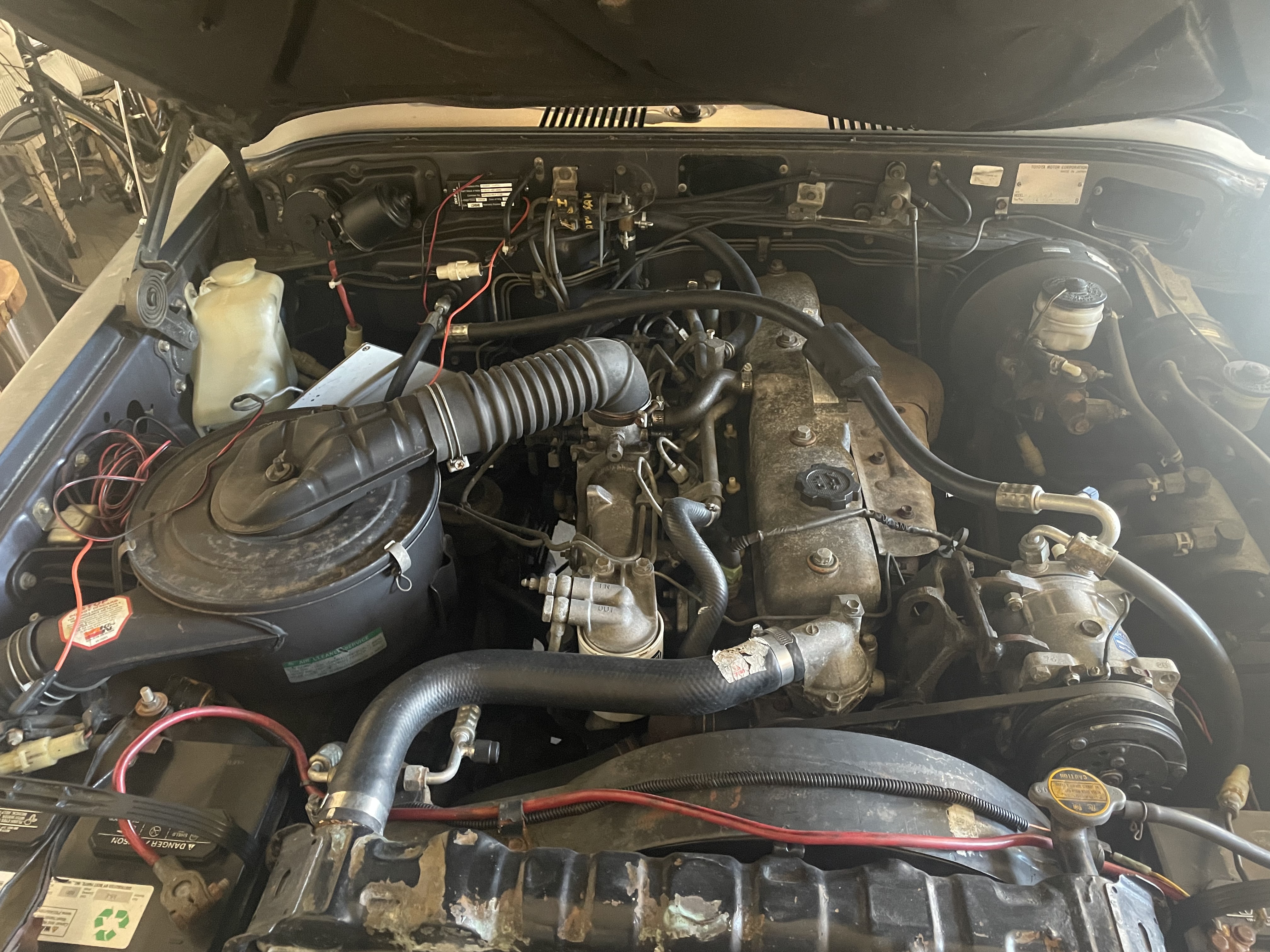

Question: What are the differences between the two oil filters HJ60
Jun 15, 2022
2
14
Deal, NJ
I just got an HJ60 and I am going to change the oil and filters. I've watched some videos on youtube and I see that their are two oil filters to change. One under the hood by the engine and one accessible from underneath the vehicle. Can someone explain the difference between the two? So far I've only ordered one filter from cruisercorps and I want to know what to buy for the second one.
thank you
There is only one oil filter.
Right hand side engine . You can reach it from underneath.
thank you
12h-t engine? the one close to the radiator and belts is the fuel filter.
