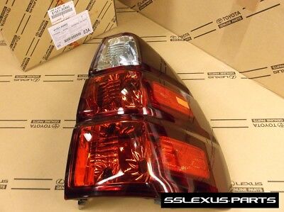

Bumping an old thread, but is there any difference between the '08-'09 tail lights for the standard GX and sport package GX? They both appear to be clear but have two different part numbers so I wasn't sure if there was another difference I was missing (maybe the sport package tails are slightly tinted like the headlights and fogs?). See below:
Standard GX (Part No. 81551-60860)
Sport Package (Part No. 81551-60870)
I think the sport rears are slightly smoked like the headlights
