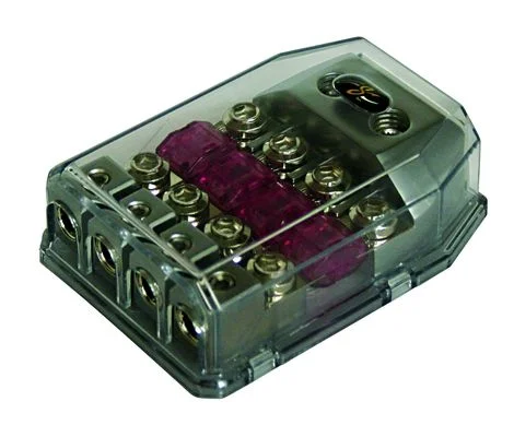

Your setup looks good (although I haven't done the math to check your fuse sizes, it seems like you did your homework and will be fine). You may want to use a fused distribution block similar to this one at the point where your large wire splits to the smaller runs.
Stinger SHD821 Car Audio 1 (1/0Ga Input) 4 (4Ga Outputs) Distribution
You can use unfused distribution blocks for the ground runs, or the post your showed earlier (which I also used in my alternator and wire upgrade).

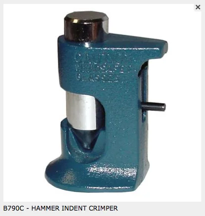

How in the heck can I crimp lugs onto 1/0 cable? I don't have a vise, or even someplace to put a vise even if I got one. Is there anyone local to me (91367) that has a cable crimper or knows anyone that does it so that I can finish up this bad boy?
NAPA has a couple of simple crimp tools - $40-60 range. Put the lug in a V groove beneath a punch die kind of thing, insert cable, whack it with a 3-5lb sledge. Not exactly elegant, but it works OK for the price.

I saw those when I started this project. But I feel MUCH safer using a mechanical joint in addition to the solder. Here is, what I think, would be ideal to use but freaking NO ONE local to me has this thing in stock! :bang:
After searching everywhere locally, it was only Air-Gas that had this stupid thing. And to make it funnier its only $15.00 which makes its cheaper than ANYONE online. For those that want/need one its Radner Part # 64002046
dull chisel and a hammer worked for me
FOR $15.00 I WILL GO GET ONE.
I used a hammer and punch when I put my dual battery's in. This tool would make it alot easier.

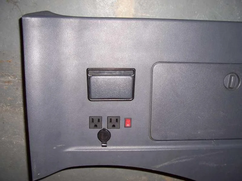

I like where you're mounting the inverter up front. Where are you mounting it in the back (unless I missed it)? I have been wondering where to install one in back. Attached is one I installed on the right rear panel of my 1st gen. 4runner.

I am currently undecided on the location as of now. The Pure Sine Inverter I am considering is the Xantex 1000 PSI. Its only two sockets.
First placement of the inverter depends a lot of how soon it is before I venture into drawer territory. Once my 3 week Yellowstone trip is over I am thinking I will be starting it pretty soon. I was trying to do it before I leave in three weeks but there is just no way.
Mounting within the wing of the drawer, above the wheel well, would be ideal. Then I would just take off the front panel and mount the outlets very near the rear hatch for ease of use. I don't like the outlets placed in front of where the 3rd row seat is because to me its just not convenient. But then again what would I be using THIS inverter for? For my uses it would really be laptop and camera equipment. I don't plan on bringing a microwave or TV. Ok MAYBE a blender :flipoff2:
IF I do not do the drawer system this year-ish then I may just mount the inverter in side of the truck behind the plastic cladding. I would also plan on mounting the new amp in the same location.
I am still undecided at this point.
That looks nice.
It DOES look nice, I'm just looking for a more convenient location. Meaning more convenient to the driver/passenger OR more convenient to the rear hatch. Being as I already have a Modified Sine Wave inverter mounted in the console, that leaves the rear hatch. There are plenty of choices really. I just need to stop being so indecisive :flipoff2:
