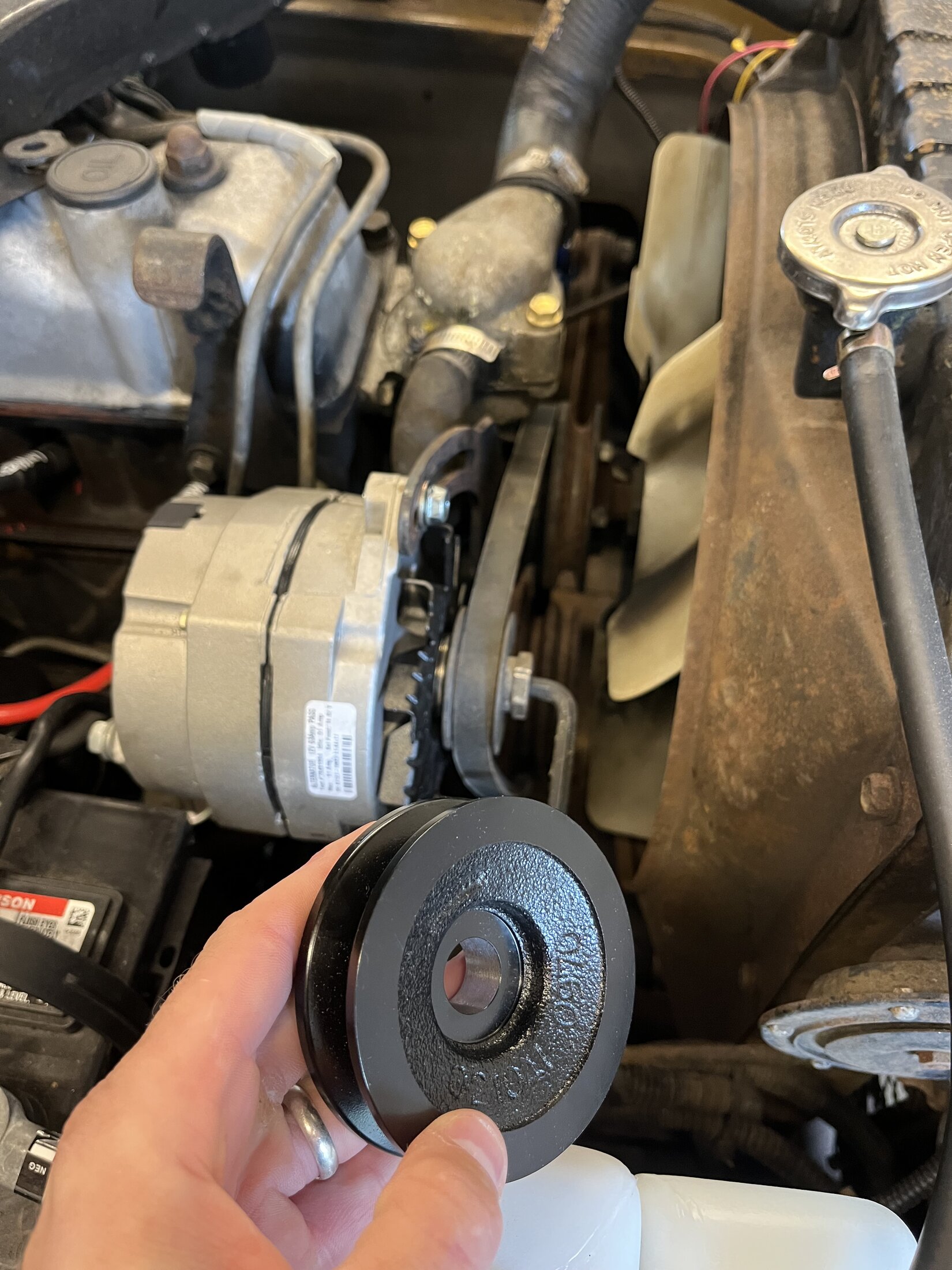

or do I have the wrong alternator?? my goal is to run a simple 1 wire alternator. Should I get a different bully for this one to get the belt lined up? It's way off without the washers as a shim.
That link does not seem to work either. Can you please send me the link to the correct pulley?
The correct width Toyota pulley will not only move the belt forward, it will properly seat it. And as an added bonus, it’s larger in diameter, so it will use more of the belt that is currently too long. Triple win.

So i purchased a stock pully from City Racer. The pully that was on it was definetly not correct and messed up the old belt. I still neded to use three washers as spacers on teh alternator shaft to move the pully forward to get it inline with the rest of the pullys. Once i get a new belt on there we are in buisness.
