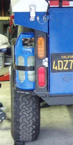

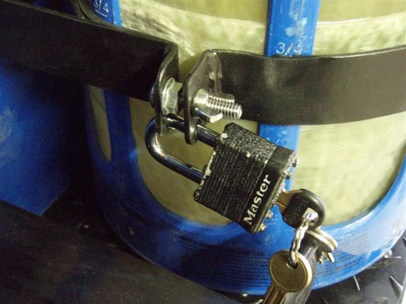

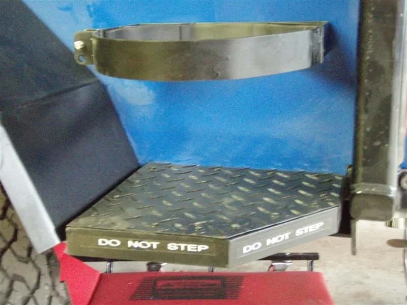

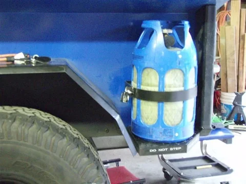

After much cursing and looking around for some prebuilt brackets I gave up and spend $10 on material and made my own..
The floor was made from 90° angle and some aluminum diamond stamp sheet that I had laying around then coated with plastic deep.
I think it came out good ...
Here are some pics...

I also opened up the fender as it used to run straight down and was about 2.5" away from the tire.....and would contac the tire when flexed. Not no more...

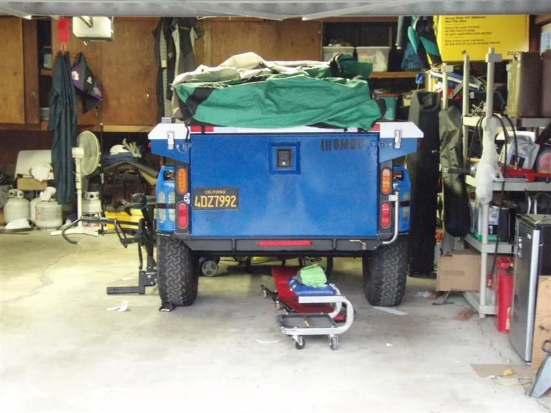

With the 10lbs tanks nothing goes past the wheel fender.
Shot from behind....... gotta like the color match !!
