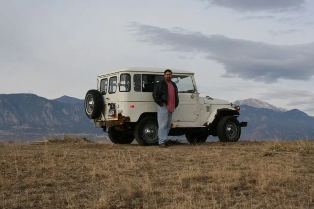

Next step find a frame. But why just buy just a frame when you can get a whole FJ40 for almost the same price. So I acquired a 78 FJ40 and just drove that frame home. .This thing was bone stock. and once again "very cheap" because of all the rust but hey I had a good body from the 75 sitting in my yard.
Next Step Go Wheeling. We took off with some friends on a fine winter day for ride up Old Stage road figured to come down the Shelf Road and then home. My Friends suggested a small detour, I protested my rig was stock and the tires didn't have much tread. They assured me all would be fine. We located deep snow drifts on the North side of the mountain and I got stuck. They pulled me out and I got stuck again lots of drama that day, our group rescued two families, one of our party fell and got a head injury got home after midnight. Wife tells me I need better tires before she goes wheeling with me again. BFG 15x33 10.5 MT should do the trick. But that also meant I needed some fender well clearance so OME 2.5 inch lift kit order was placed.
Installed the OME lift over a weekend, When removing the old suspension Heat as in a torch was helpful getting the bushings out. I sear the shocks were original. Installing the new suspension wasn't too difficult. Probably easier with two people than one. Used tie down strips to get axles lined up properly. There was a pile of melting snow then kept sending a trickle of cold water down my back whenever I was under the LC. Then it got windy and tumble weeds kept attacking me by blowing under the rig. Note to self and others. Don't forget to work to spec all four spring plates. Took LC out for a test drive and got the "Death Wobble" had to change my shorts. Anyway once I got everything tight LC steering behaviors was better than new, ran straight an true and no wobble. Next step Wheels and tires.
