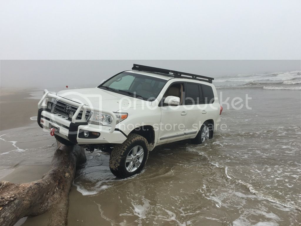

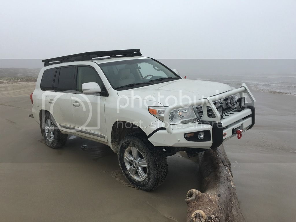

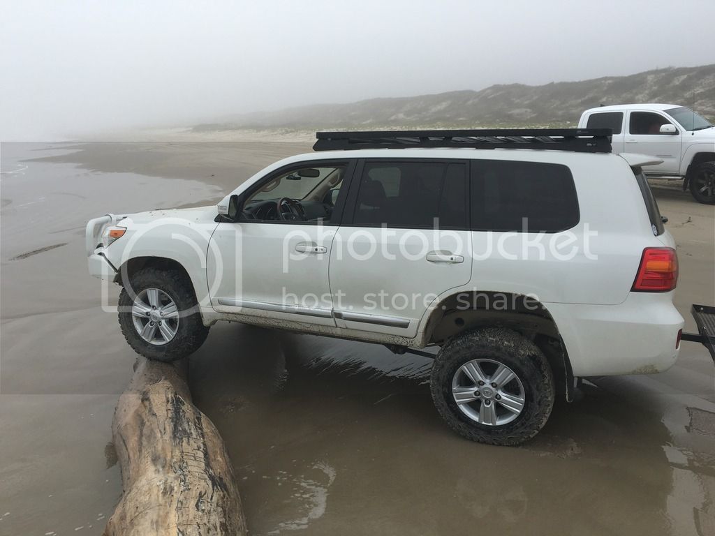

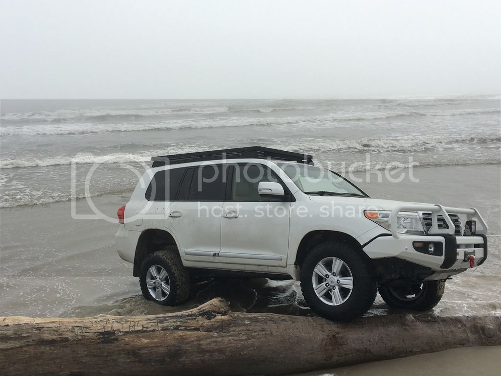

Just picked up the rig today from my local 4-Wheel Parts and am very happy with the results. My stage 1 mods consist of.
-OME BP-51's coilvers
-Medium OME springs in the rear
-ARB front end color keyed in pearl white
-7 inch Rigid flood/spot lights
-Factory style interior switch for lights.
-Warn 10,000 pound winch with synthetic line.
-Optima yellow top battery
-275/75/18 BFG All Terrain KO2's (33.2 inchs tall)
-Spider Trax spacers
The truck runs and drives better than new with the new BP-51's and does not rub at all lock to lock with the larger tires. I can't wait to take it the beach this weekend fishing down big shell in Corpus Christi. I will update the thread with more pics as the build progresses.

That's awesome, just a question, is the front camera &a radar still working?
Now that is a NICE looking truck! Congrats on the build!
Whoooo Weee! That's a good looking rig!
I decided to go with the 7 inch ridged lights vs. 9' ARB's because it would not affect the radar cruise control. I love that feature and did not want to lose it. The front camera also works great as well.
Sweet!
Which Warn winch are you running and where is the solenoid mounted? I like the clean look.
We mounted it within the ARB bumper. 4 wheel parts did a excellent job making sure it was secured underneath with the plug pointed toward the front of the bumper so connecting the remote is easy. I decided to go with the VR 10,000 pound winch.
Well done, very aesthetically built. Did you order the ARB bumper color keyed from factory?
Sent from my iPhone
2002 LX470 expo ready
2008 Ford E350 EB V10 4x4 Sportsmobile PH top
Custom off road trailer
I don't think ARB offers that in the US.
Sent from my iPhone
I don't think ARB-USA offers that...
Think Australia only?
I had it painted by a local shop prior to install. Thanks for the compliments.
