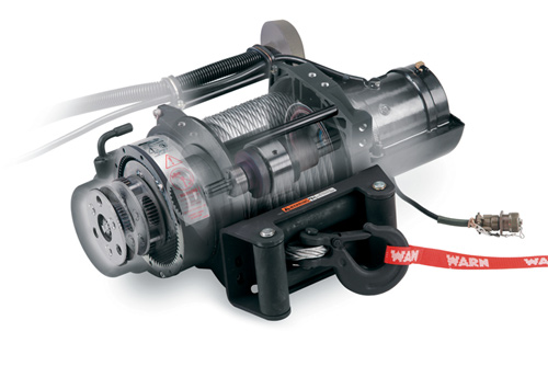

I need a winch or two with big pull and absolute reliabilty. Enter the Warn Series 12 Deep Fording Winch, which is basically a version of the military HUMVEE winch. Well enough just can't remain, so a 6hp XP motor will be installed, possibly some synthetic line... and we'll see what else...
Warn Industries - Severe Duty 12 Deep Fording Winch

This is the newer Industrial Series, a far cry from the reportedly troublesome Humvee winches of the 90's. Most of those were rated for 6k and 9k, quite a different animal.
Humvee winch

The newer industrial winch is well sealed, uses a contactor, has thermal overload etc etc.

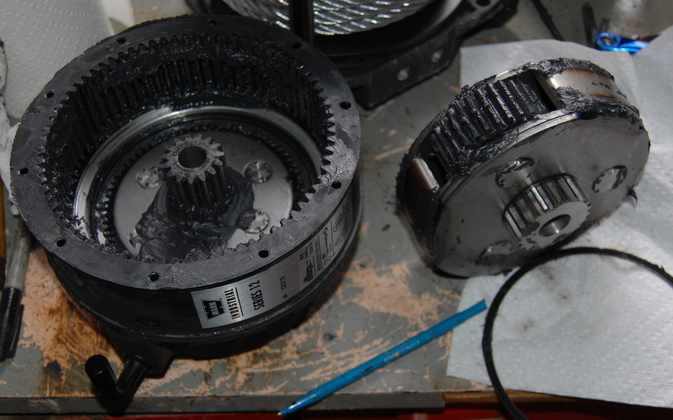

The gear ratio and component size place this at or above a consumer 16.5ti. The 16.5 has a 3.5" drum, the series 12 a 4" drum. So with the 4.6 motor, not quite as much pull, add the 6hp motor, and we can speculate that it will be back up in a similar area. This also changes the line speed calculations a bit.
Gear box is large and heavy, sealed, might have to add a breather. Anyone ever convert one of these to gear lube?

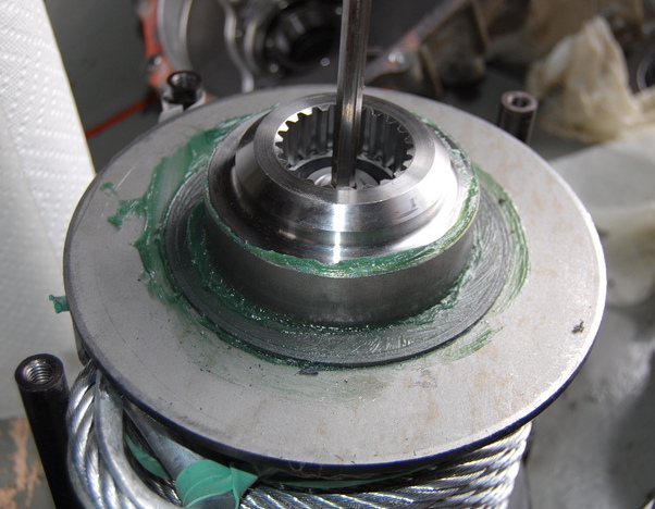

Large 4" diameter drum bearings. Real doube lip seals, possibly viton.

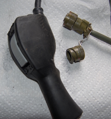

Remote, large rocker switch is easy to use with bulky gloves. Plugs are keyed and waterproof.
