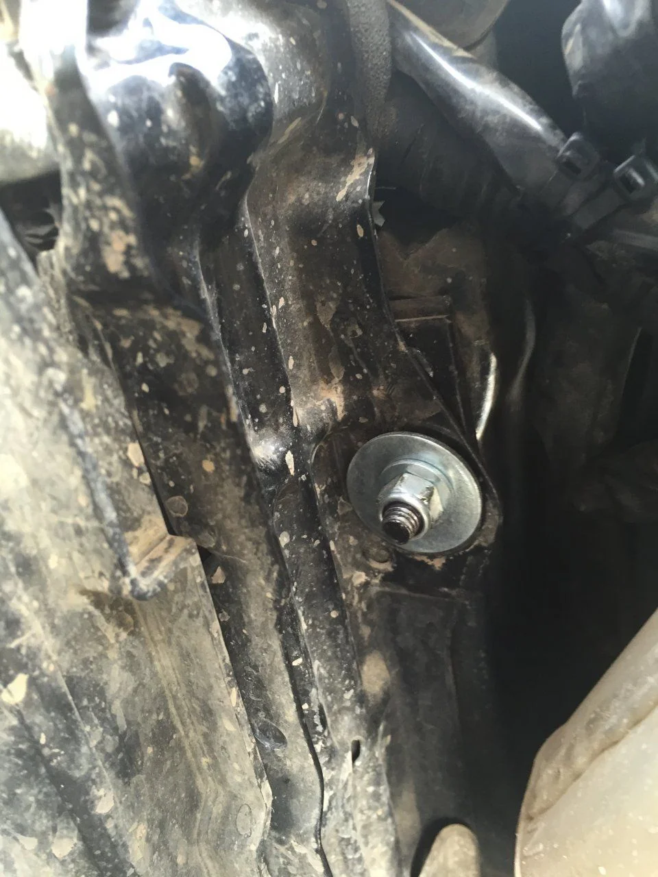

Puck #1: I removed the front bumper to get to this. I liked having the extra space. As OP mentioned this is a bit of a bear to get out. I used all my extensions and a toggle socket with my impact gun. The pass side was rusted in so I had to apply a torch and a lot of effort, but I finally got it out.

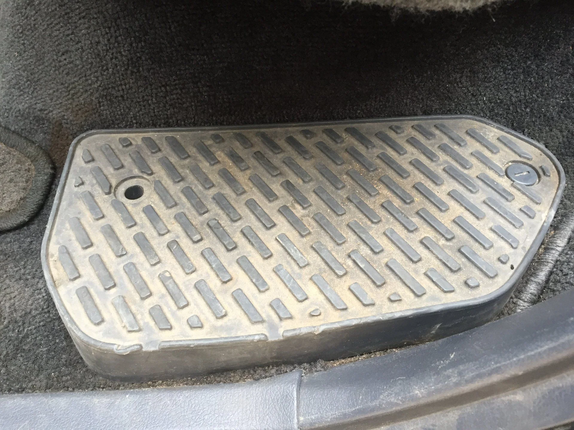

This is the location of DS puck #4. You'll find it under the plastic step plate by the rear seats.

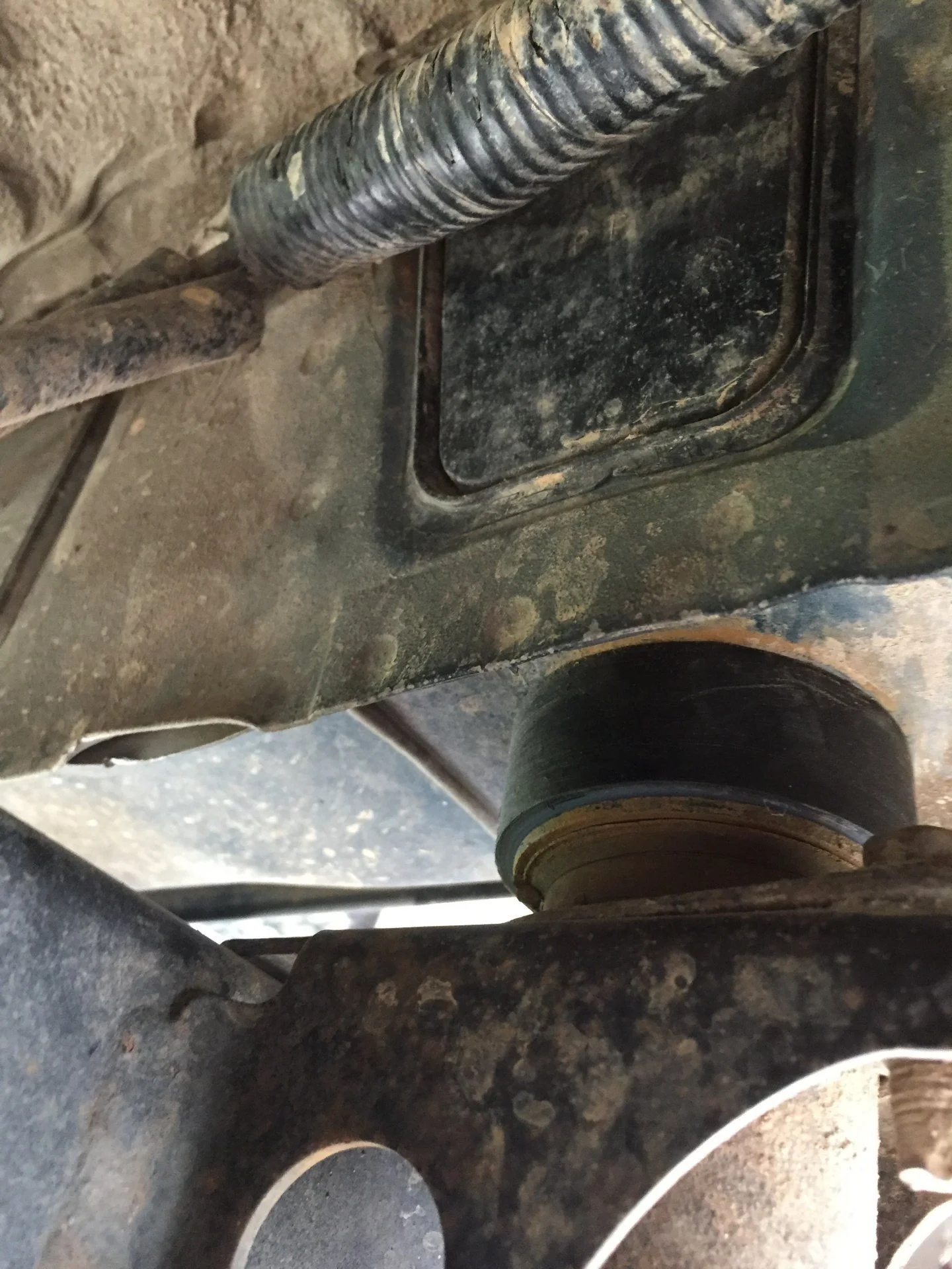

This is the location of DS puck #5. There is a square(-ish) plastic panel that you can pop out with a flat screwdriver to access the bolt head. As OP mentioned, it's a hassle to remove this bolt because of the size of the access panel but with the 1" lift you can just move the bolt up and out of the way, insert the puck, and reattach the original hardware.

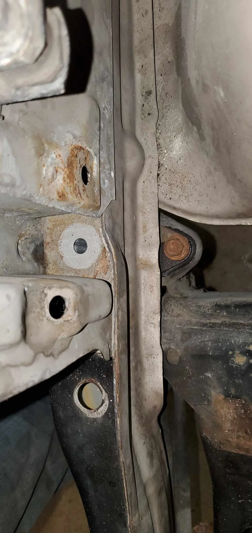

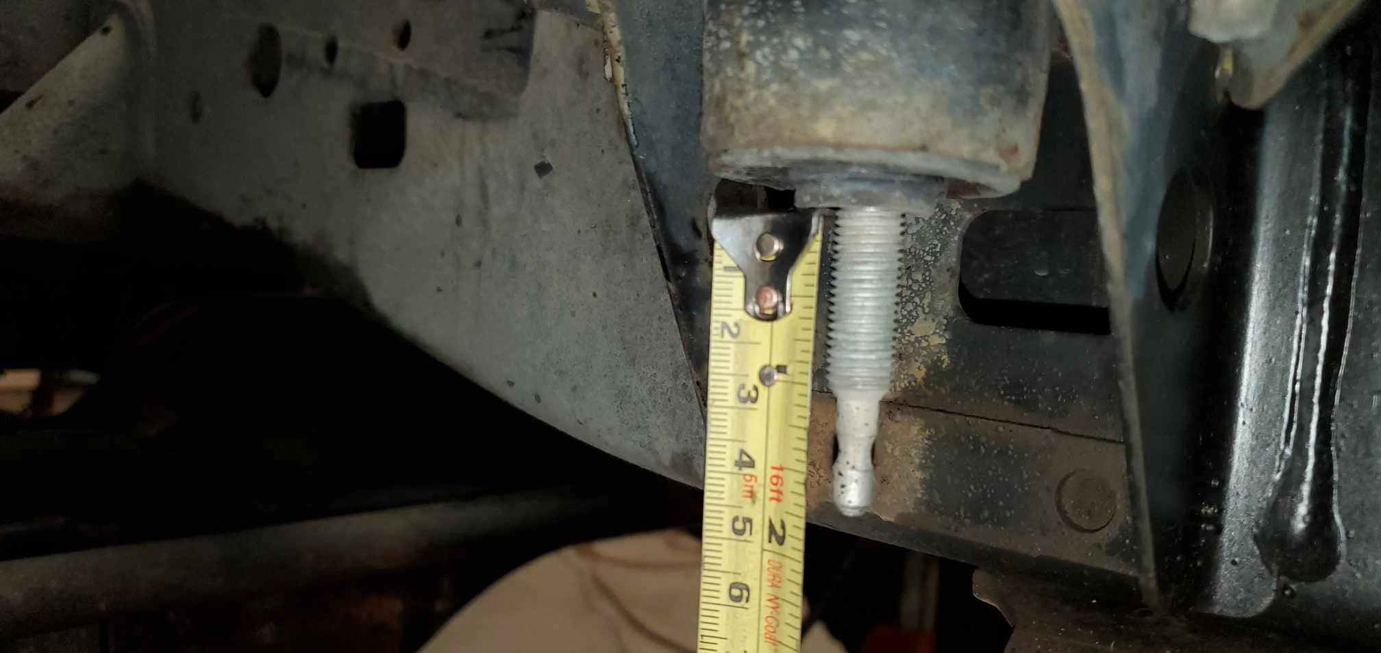

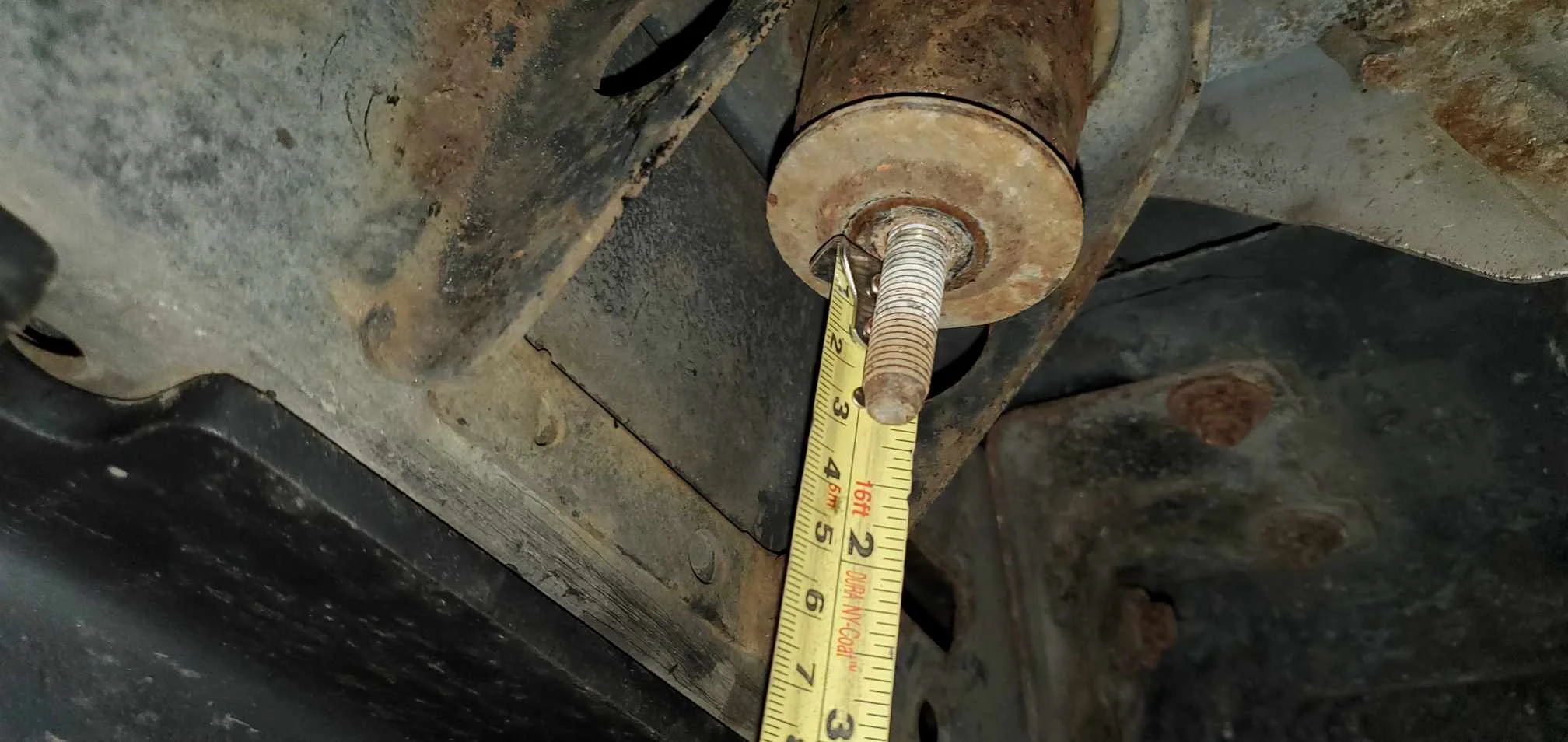

I wanted to add to this thread since it was missing the stock bolt lengths. The front mount bolt is 6.125" long and the threaded area below the washer is 1.5". The mid mount bolts are 4.313" long and the threaded area below the washer is 1". And the rear mount bolts are 4.75" long with the threaded area below the washer 1.5". Based on these measurements, I'm going with 6.5" long for the fronts, 5" long for the mids and 5.5" long for the rears. for a 1" lift. I also took a pic of the front mount since I have everything out of the way currently getting ready to pull the engine.
