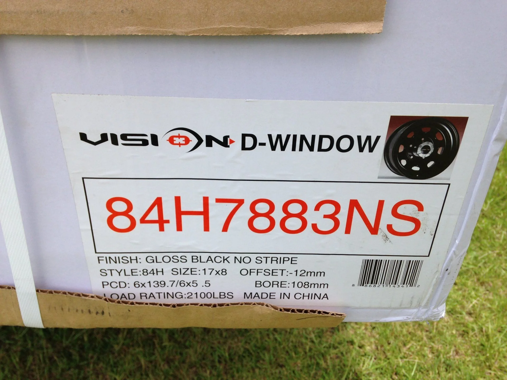

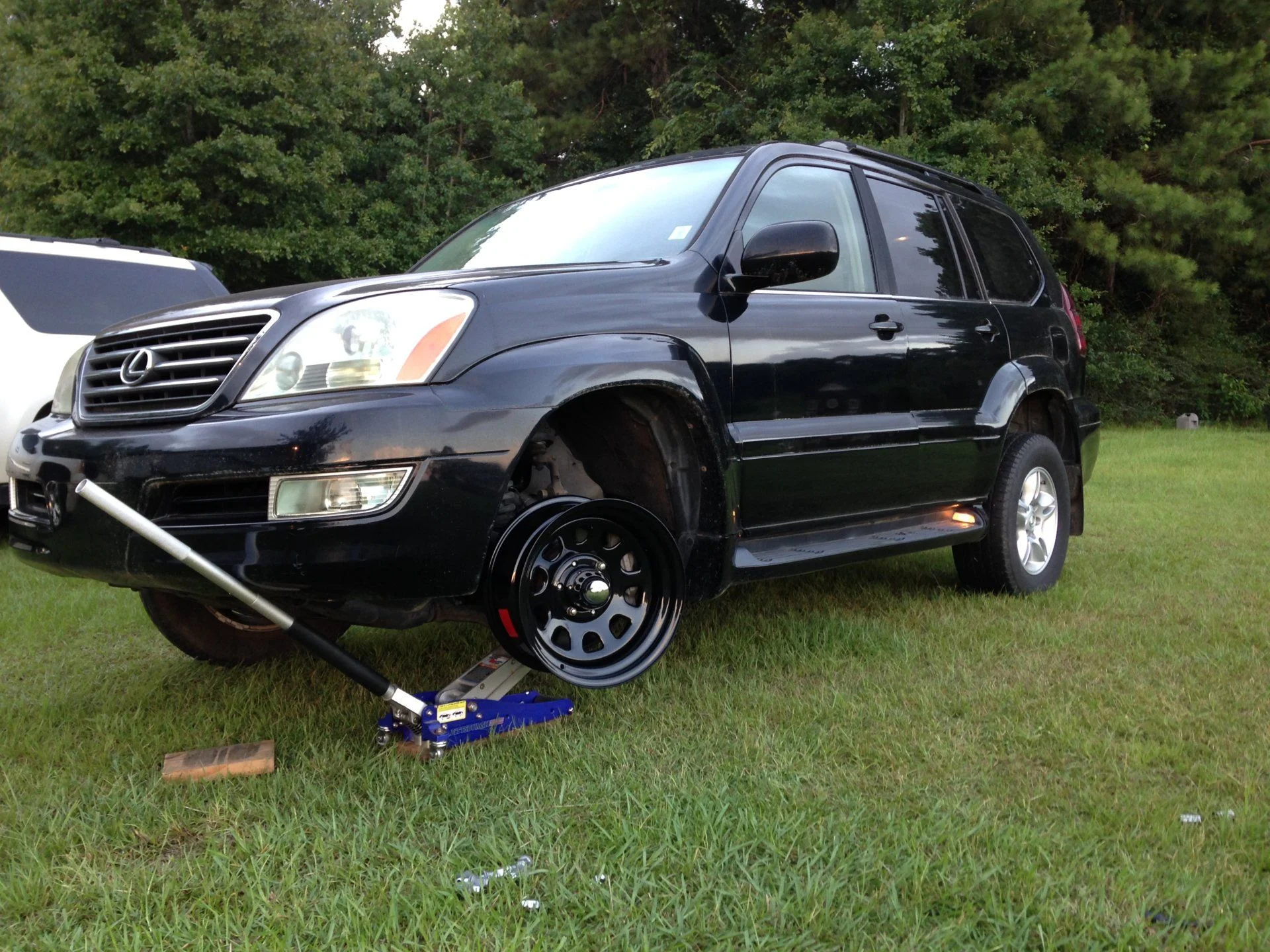

I tried a set of stamped steelies and it did not work. There isn’t enough space to clear the brake calipers. Other than not clearing the calipers, they would’ve looked great.
You’d need to order them with a high offset/low backspace so that you could run a set of spacers like SpiderTrax or the like. The actual 8” barrel of the wheel is the same across the run of 8” wheels. It’s the position of the center part/hub that sets the offset.
Hopes this makes sense. I would’ve loved to had ordered correctly but didn’t have time to reorder a second set.
A 17x8 with 5.0” backspacing/+12.0mm offset should land out at the fenders using 1.25” spacers. Unless my math was wrong back after I ordered the wrong ones.
