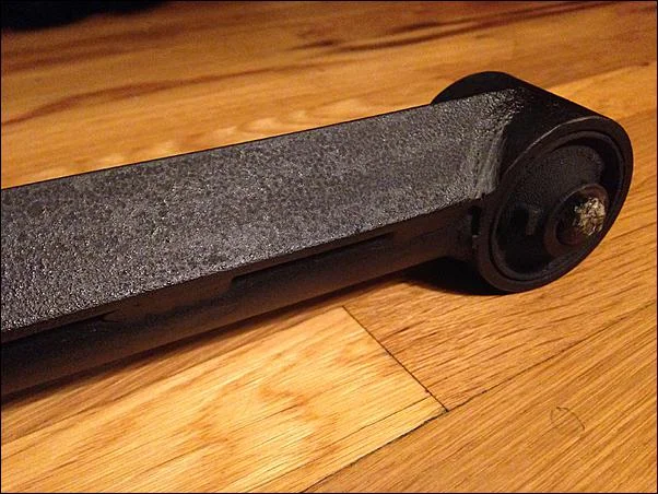

Your stock lower control arms on rear axle will bend at the mere sight of boulders in Moab. Just be mindful when you are ascending/descending ledges and you might be able to spare them from bending. Carry a spare or reinforce the stock ones with some welded angle iron (quick fix) on the bottom edge. If you plan to wheel this more regularly, then I would consider aftermarket upgrades.
Any pics of how you reinforced them? Would you consider that being the weakest point ? I worry about the weak rear diff but there’s nothing i can do in two weeks time to remedy that , I don’t wheel super hard but would like to comfortably wheel and not be afraid of destroying it. My buddy is bringing his 2016 stock Tacoma so I’m thinking he would be the first to break something haha..
basically weld a length of angle iron that has been notched at each end to match the round bushing ends. Edit to add, I did not personally do this, but it's a relatively quick/inexpensive method to beef them up. I ran stock until they bent, then upgraded to Metal-Tech. Now I have recently upgraded those to Summit Machine arms. But there are lots of aftermarket options that will be a huge improvement over the OEM ones.

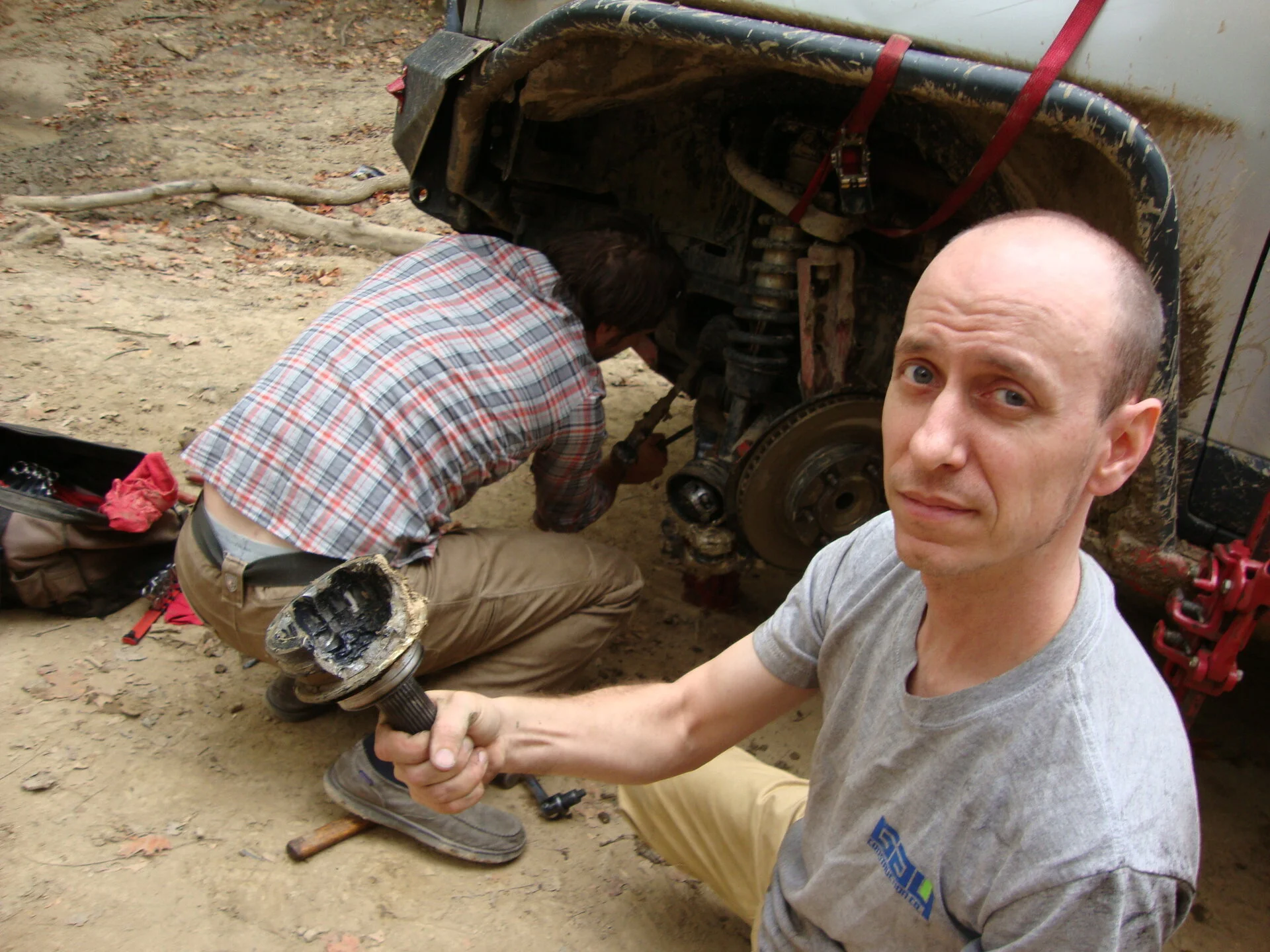

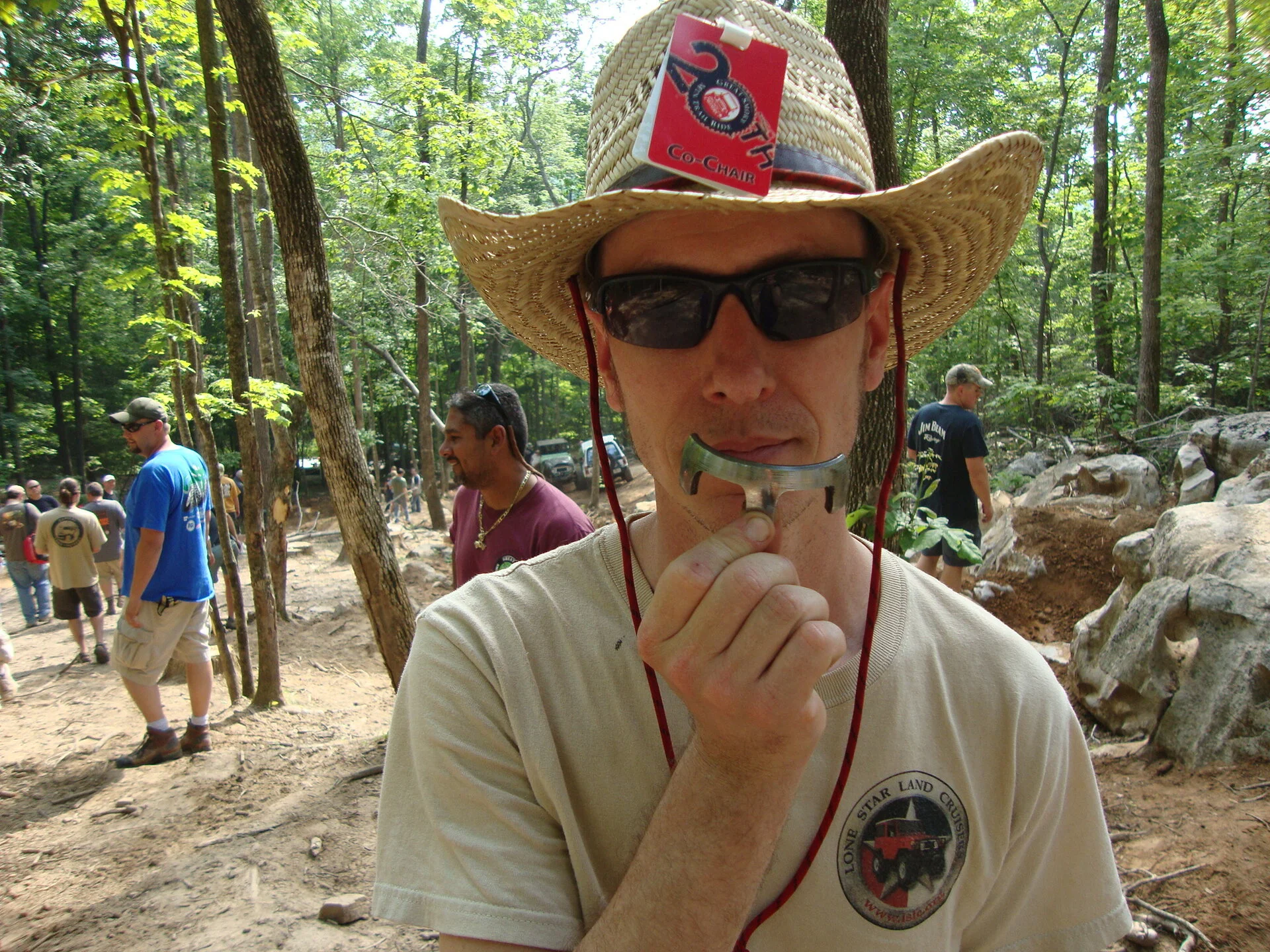

This was after participating in a rock race at Golden Mtn. My wheel caught some air and was spinning pretty good when it came back down. The ball bearings shot out at the spectators and the cage was found in a couple pieces. The star is now my tcase shifter.

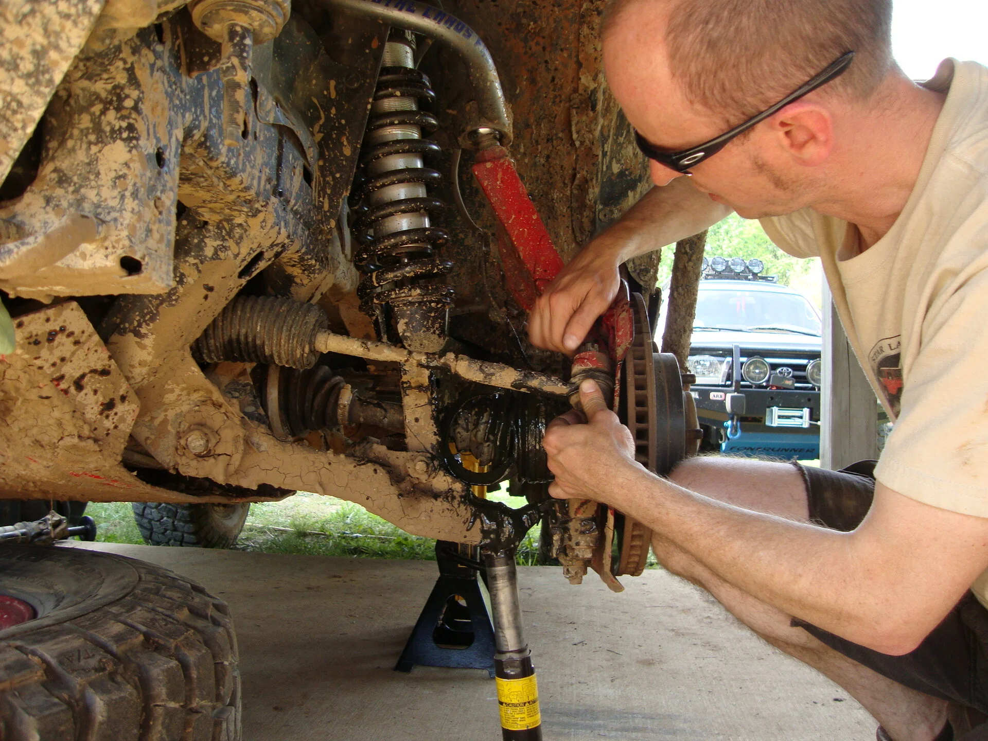

We swapped this one on the trail in about 30 minutes. This one, THIS ONE was the last time I bought an aftermarket cheap axle (Napa I think). It was brand new when it gave up in a mud hole. Never again will I buy a cheap CV axle. We put an old OEM one back on and I kept it on until I got a new one from Toyota.
The reason they are often carried as backups is that they are reasonably easy to change, even on the trail. You certainly don't want to be driving with a broken one any more than necessary as it could flop around and take out other components like shocks, brake lines, tie rods...

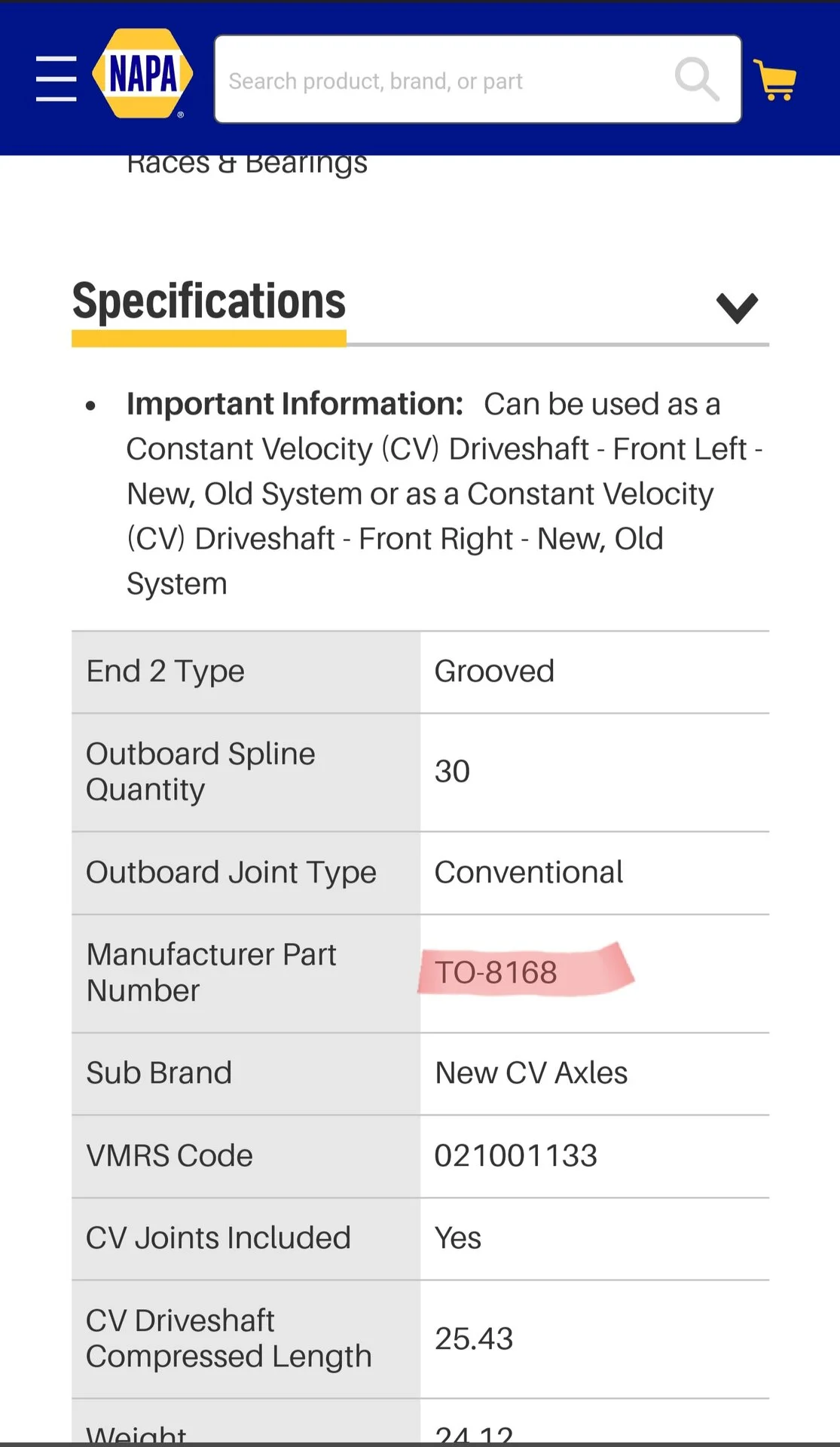

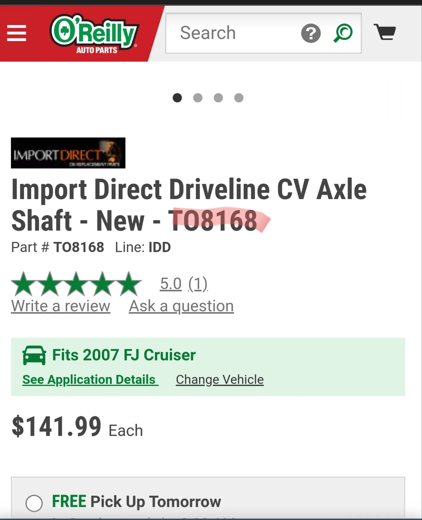

OEM CV axles are pushing 400 dollars , surely there has to be a different option , I read that the Napa ones aren’t bad now you have me rethinking…
You need to befriend your local dealer parts counter staff ;)
The most recent one I purchased was from CVJ Reman and they use OEM parts with upgraded boots. I have yet to install it though, so I can't honestly rate them yet. But it does look like a decent option.
I'd trust the Napa one to get me home if it wasn't a 4x4 situation. Keep in mind there are a lot of FJC owners that don't use their rigs offroad that will say Napa is just fine.

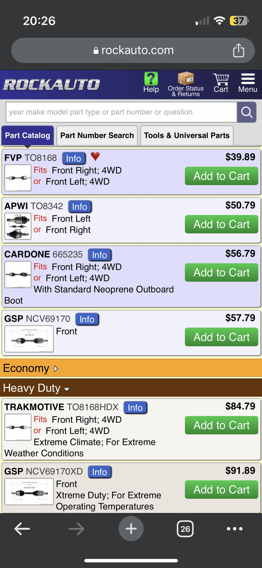

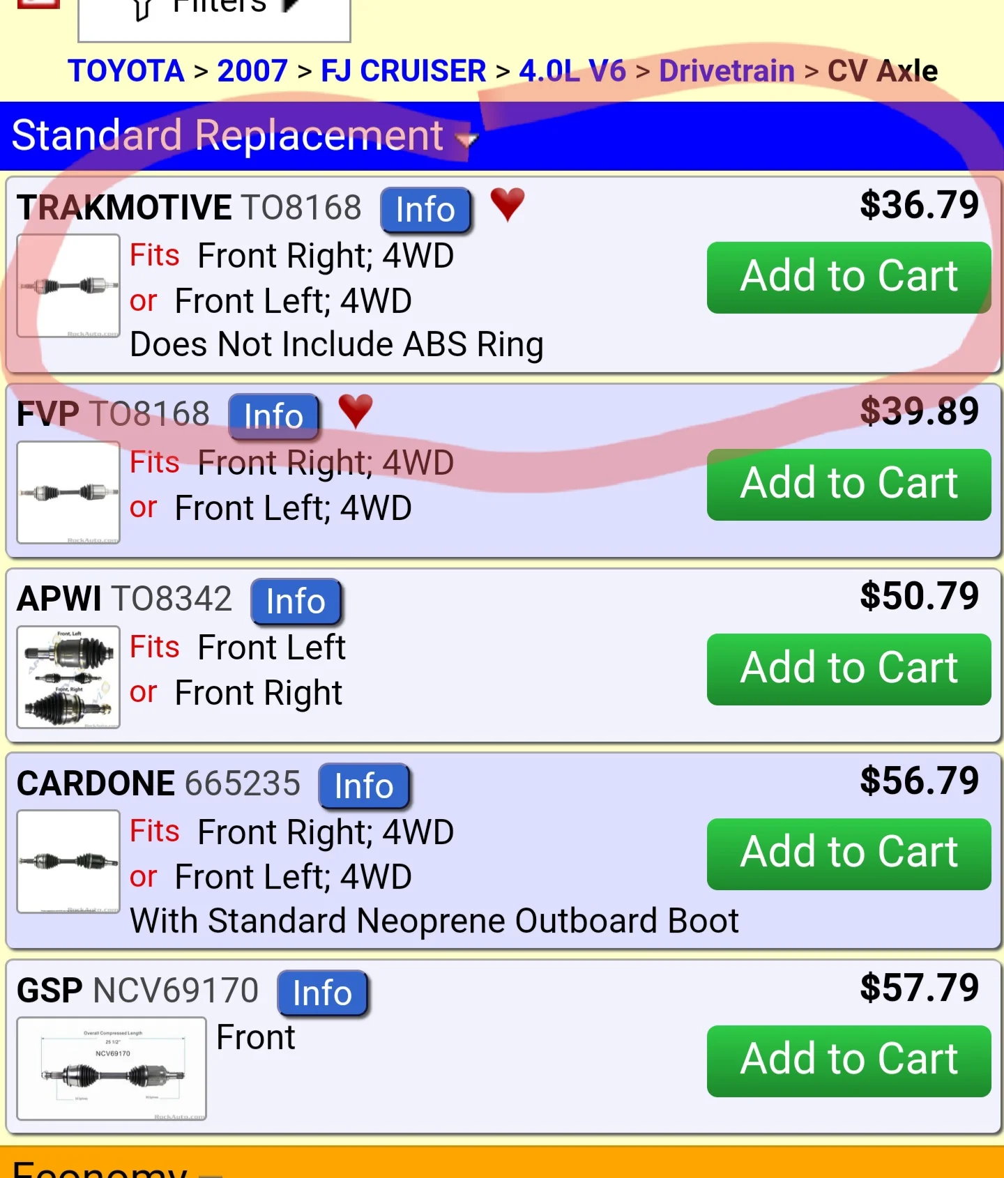

Napa ones were the go when they were $80 Cardone HDs, now you pay $140 for what is a $38 Trakmotiv cv on rockauto.
Mine that popped this weekend in a mud hole was likely hurt already or worn but likely cheap parts store to begin with. OEMs have the superior articulating trilobe setup to not bind at full droop. While I hate driveline "fuses", replacing a CV is much preferred to a busted front diff.
