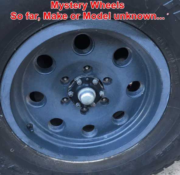

The BFG KM2s seem like pretty serious mudders; did I mention they're noisy? The Nitto Terra Grapplers look to be decent AT M&S that will be much quieter on the highway. Both tires standing side by side appear to be nearly identical in height, the BFG being an inch or so wider and with much more aggressive tread pattern. I tried swapping them today to test that theory, but the Toyota alloy lug nuts won't fit the new (unknown brand) wheels. And someone radically over torqued the lug nuts on the '97 it was all my Harbor Freight 250 ft-lb electric impact driver could do to crack them loose... So I'm in search of the proper lug nuts for the new wheels...
