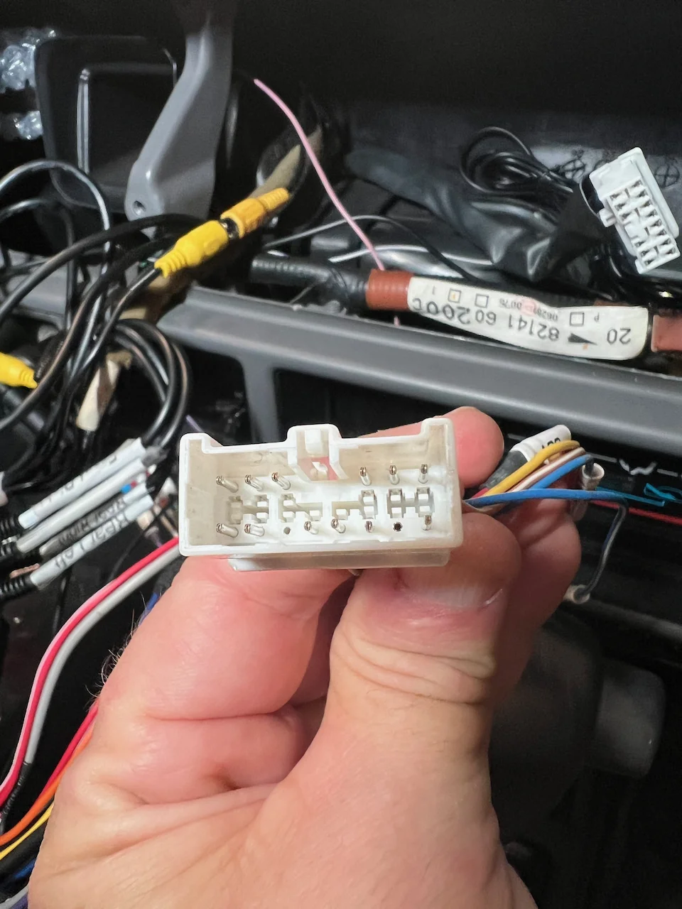

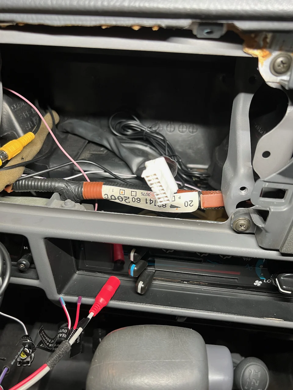

Here’s what the 14-pin connector looks like after disconnecting your factory (or aftermarket) HU:

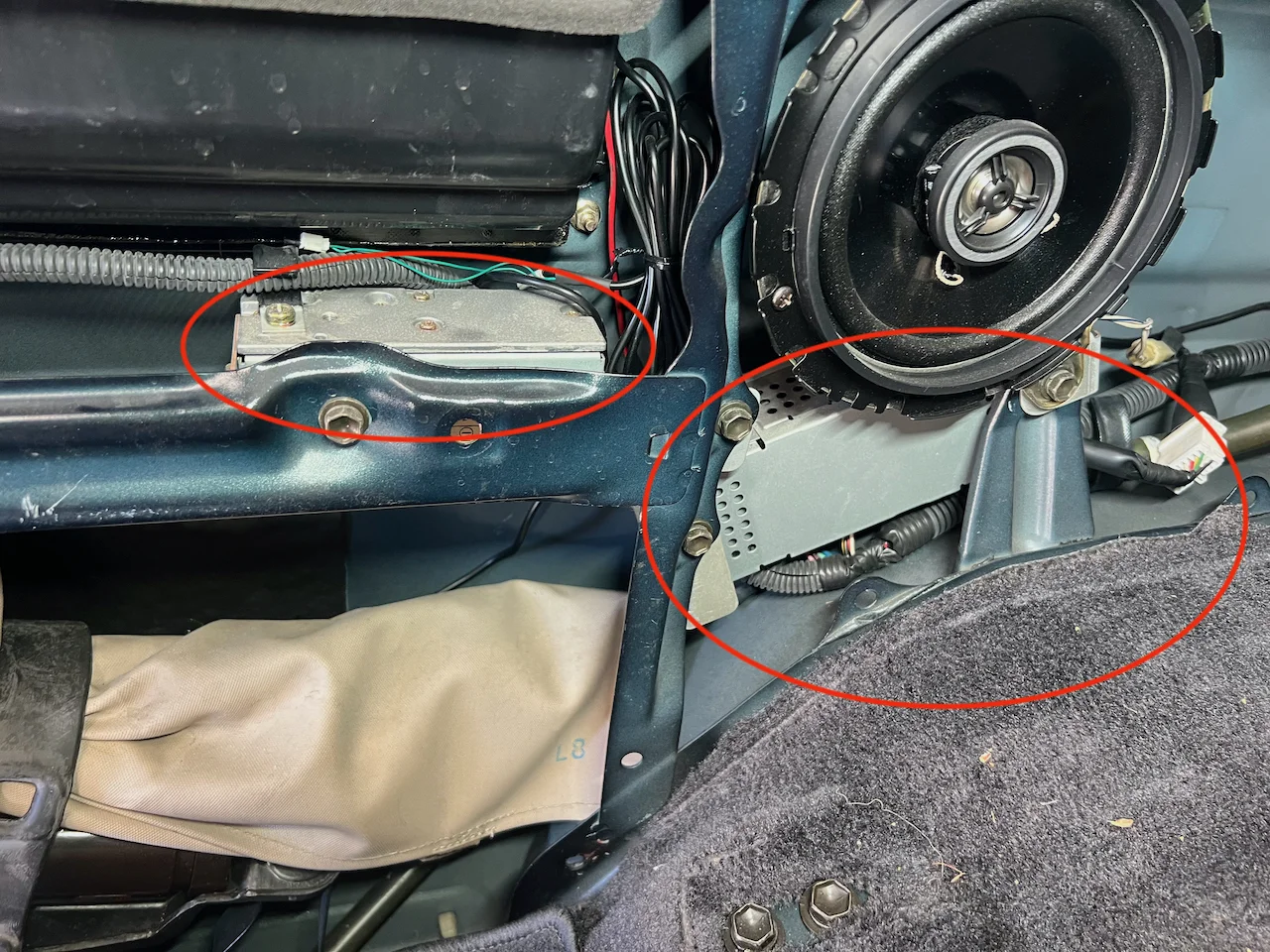

Here are the rear amps - one above the tool pouch and one below the speaker (for information only - you don’t need to access these to replace your HU).

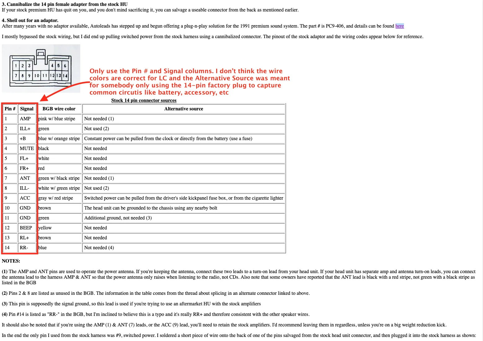

Wiring Diagram for the factory 14-pin plug:
Here's the wiring diagram for the 14-pin connector that I found on an MR2 site, but it does include some notes that don't apply here. I don't think the color codes match up with Prado, so you'll have to pay attention to the connections on your old stereo or do some testing to orient yourself and ensure you're reading the diagram correctly. The column about "alternative sources" was only relevant to the guy that wrote this... I think they were installing a new amp and were only using the factory plug to grab common leads like battery and accessory power, not audio. The notes also reference the "BGB"... had to look that one up as I hadn't hear it. It's the "big green book", which I assume is what MR2 owners call what we here call the FSM or EWD (field service manual or electrical wiring diagram for those visiting the site like I was the MR2 site).

Cut the male side of the connector with enough wire as a pig tail to work with comfortably - anywhere from 2-4". The male side will look like this:
The wires from your HU pig tails will be connected to the male 14-pin connector like this to make your "Metra like" stereo harness (stereo pigtail lead --> 14-pin connector position):

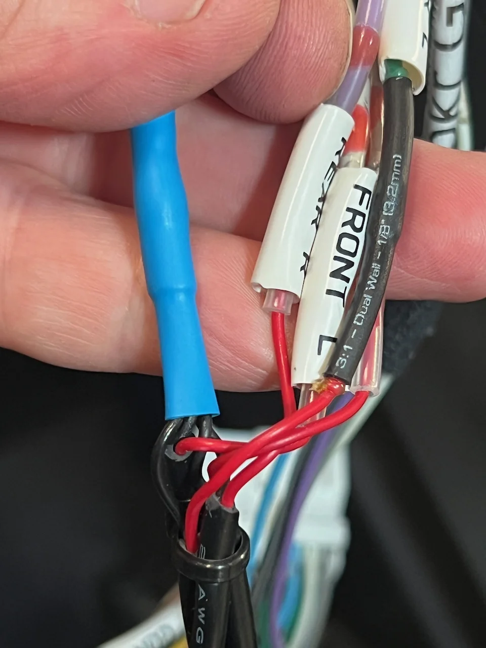

It's this last one - connecting the negative leads from all 4 audio channels to the shared negative pin 11 - that I think tripped everyone up who was trying to reverse engineer the wiring diagram. Here's what it looks like - the four positives / red leads from the RCA plugs connecting to their designated pin, then all four negatives joined to the shared audio ground pin #11 (under the blue shrink wrap). The key for this to make sense is unlike the standard setup (HU sending speaker level outputs directly to the speakers through a separate positive and negative wire per speaker), this is sending low level outputs to the amps in the rear. To do this it only needs 5 wires - one positive per audio channel plus a dedicated audio ground to serve as a common negative.
