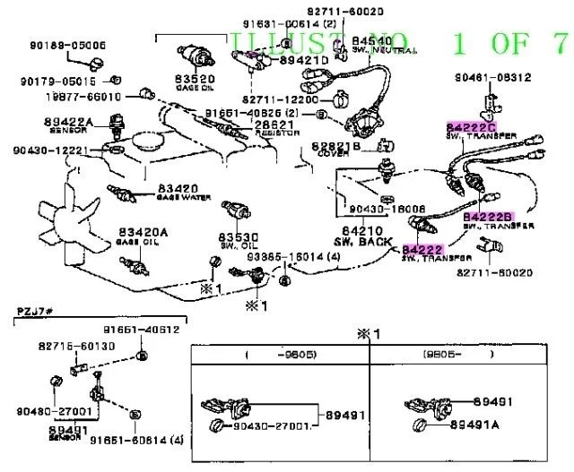

I was hoping someone could help me to find a part for my 1990 Prado. My mechanic describes it as a transfer case indicator light switch. It is located on the lower part of the transfer case near the shifting motor. This is the switch to send a signal to the dash light to indicate whether or not 4H is engaged. The number on the existing part is 424-0. If possible I would like to know where I could source a replacement. Thank you.
I'm sure I'm completely wrong, but here is a diagram from '90 70 Series:
The highlighted parts are called "Transfer Indicator Switch 1" Transfer Indicator Switch 2", and "Transfer Indicator Switch 3".
Let me know if I'm anywhere close or point me in the right direction and I might be able to help you!
