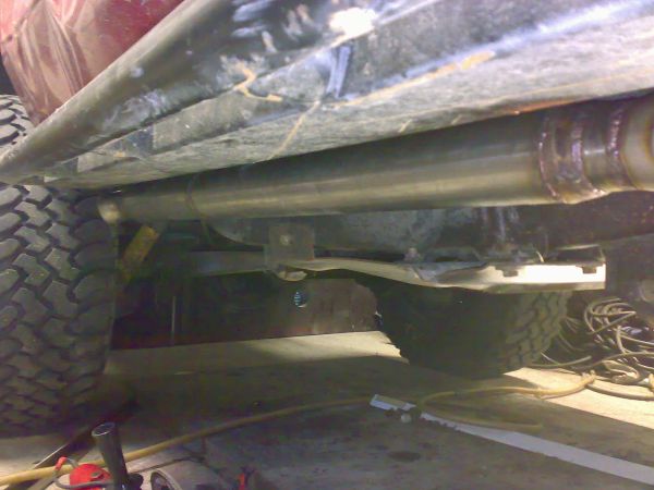

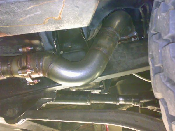

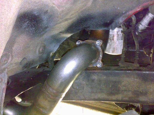

Whole pipe is stainless steel, homemade

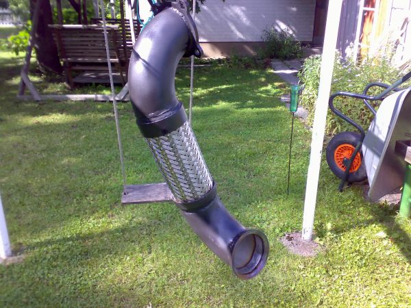

3" downpipe, painted with black satin

what did you use for the 'muffler'
