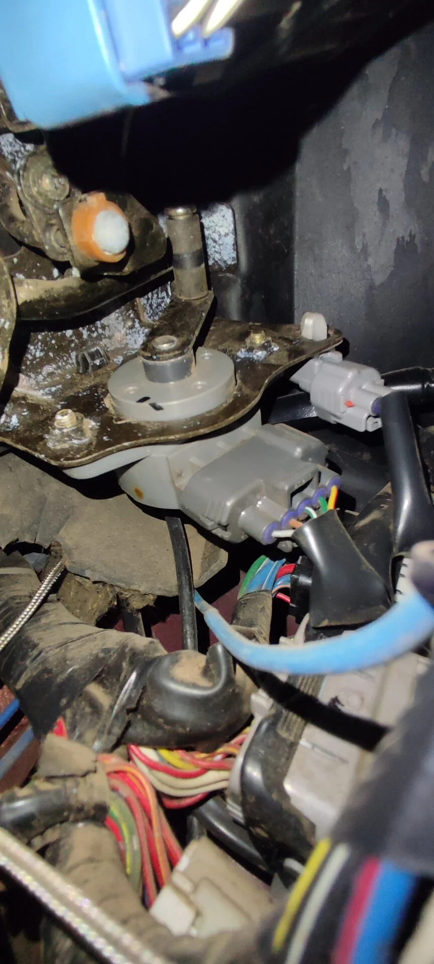

I am thinking this may be electronics related issues like ECU, Injector Driver Module or Accelerator Sensor which this model have.
Does anyone out there have encounter this incident?
Can anyone shed light what causes this Runaway Diesel?
I welcome any comments.
Thanks in advance.
Sounds really odd man. I wonder if it's something to do with this thing that your accelerator pedal operates? I don't know much about it I'm afraid. Maybe check those plugs are seated properly in the sensor and check the wires aren't frayed or damaged at the back of the plugs.

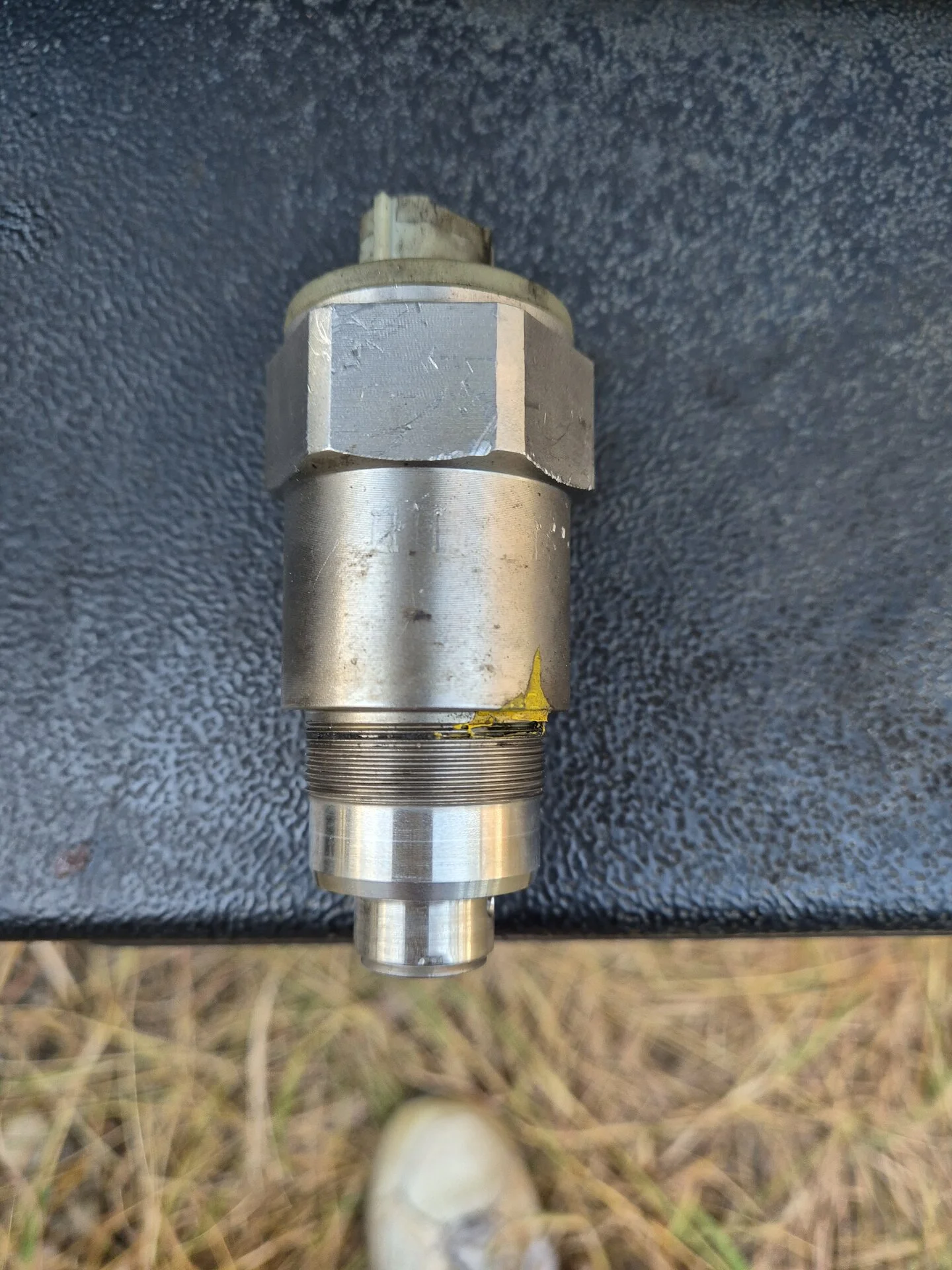

Reading your post again, it does sound like over fuelling (with the black smoke). Possibly an issue with the spill control valve getting stuck open?
Have a read through this. Might be of use?
Thank you so much for replying.
I will check the Spill Control Valve when I am next over at my mate workshop, that's where she is atm.
Peddle Sensor photo is identical to mine.

It wasn't the Spill Control Valve/Solenoid, I serviced while I am at it, it is working as it designed to.

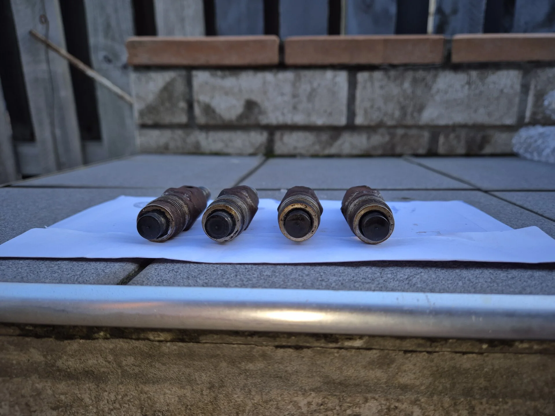

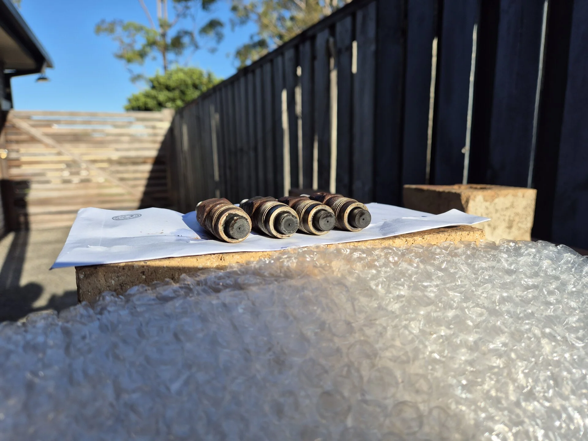

It turns out I have serious diesel leak into the engine oil system.
Checked the oil dipstick, level was extremely high, thin and strong diesel smell.
My good mechanic friend concluded the injectors must be leaking badly flooding the combustion chambers then make it way to the oil sump over the two weeks. There's no other way diesel can get into the oil sump.

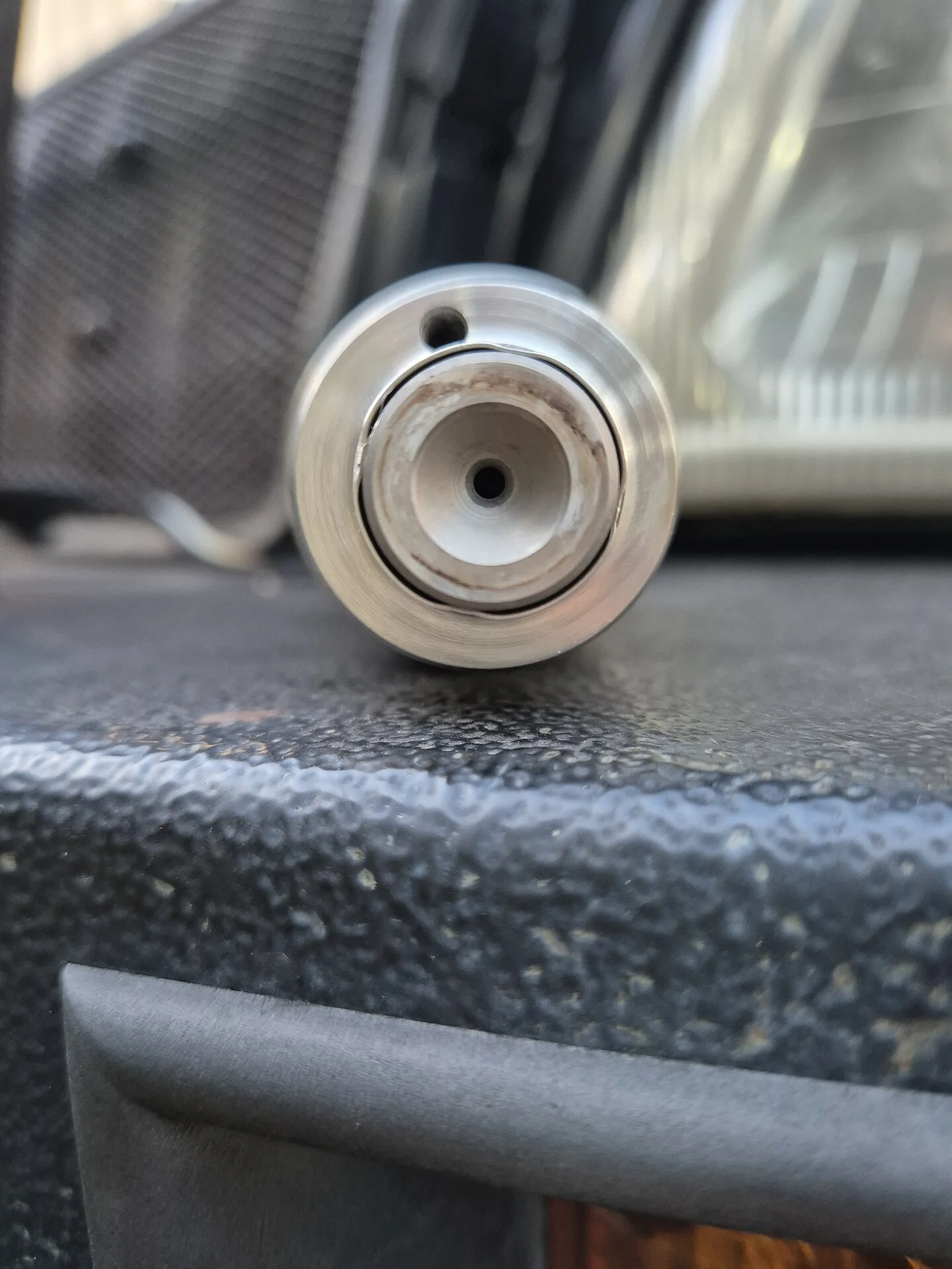

I have pulled out the old injectors, all were missing the small washer between the Top Hat and the injector nozzle.
My mechanic friend said, the missing washers are unlikely the caused the diesel leak.
Two of them looks pretty bad, I am waiting for feedback from injectors specialist where I have got them from on an exchanged deal.

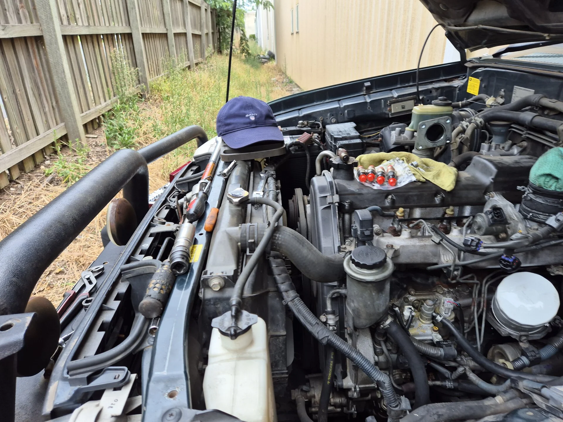

Refer to attached photos of dirty injectors, 4x replacement injectors with red caps and Spill Control Valve/Solenoid condition after serviced for your review.
I have installed the reconditioned ones with genuine Denso nozzle.
