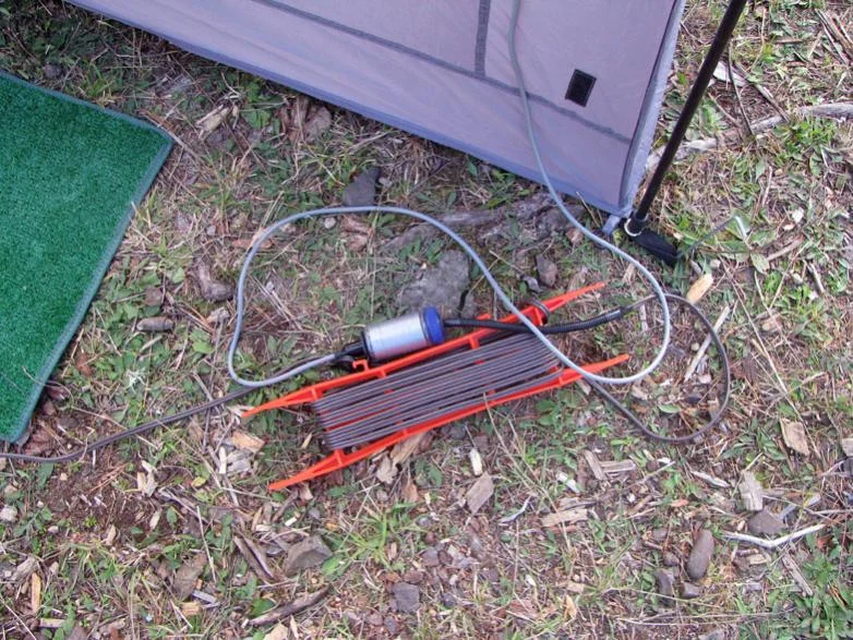

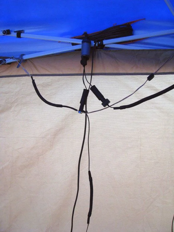

Hope the pics help. But the idea is simple.
I use 16 gauge brown zip cord, the kind that you can use for lamp cord or that you see in your common cheap extension cord in brown or white. I use brown, because it doesn't show the dirt of camping like white does.
On one end I solder on a 12 volt receptacle, using proper strain relief. Since it's an extension cord and will get tugged even if you're careful, soldering is just about required for reliable connection. The one in these pics is installed in an old chili powder container.
I use one of the those cheap orange plastic extension cord winders to hold the wire neatly, wrapping it around that and unwinding as needed.
On the other end, you have two choices. In the past, I got a small pair of clamps like smaller version of the ones on a set of jumper cables. Just clamp it on your battery posts, lay the wire where it won't get cut and lower the hood gently, leaving it partially caught. You can hang the orange cord winder on your sideview mirror if you don't trust yourself or others to drive off before unhooking the extension cord:doh:
After installing several 12 volt sockets, I made another extension cord, but this one has a standard 12 volt power plug on the end. I plug this in inside the truck. It has the advantage of being fused.
Never fused the clamp-ended cord, but was always careful about it not getting cut. Be careful whatever you do.
I also keep a couple of those two-receptacle pigtails in the truck, too. This permits me to plug multiple items into the one cable.

BTW, the pics with the cord winder stuck up in the eaves of our awning show it in position where we plug in our LED lights.
PS I think that last pic is "enhanced" with my camera flash. However, those LED strings are bright. We want to get a couple more, so there's a string on each of the four side of the awning. Then it should be bright enough for these old eyes to read without supplementary lighting.
