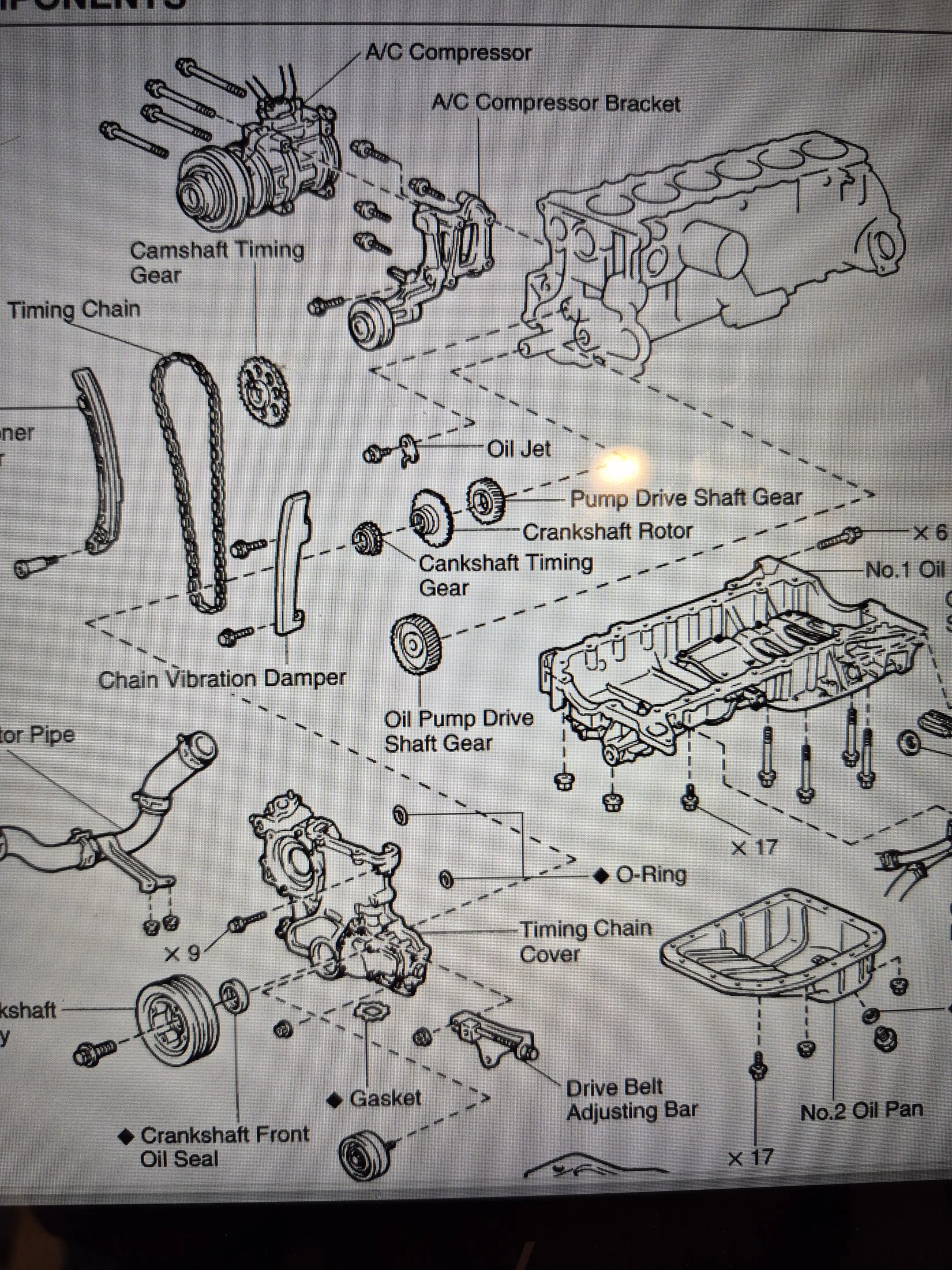

Actual solution: Tighten crankshaft main bolt. The gear on the crankshaft that drives both the oil pump and power steering pump is only pressure fit onto crank and is "squeezed" by force from the main crankshaft bolt against a shoulder on the crankshaft. Since the bolt was loose, the gear could slip and wouldn't rotate - hence not driving either the PS pump or the Oil pump. The shuddering would happen when the gear would intermittently "catch" on the crankshaft and turn. After tightening the crankshaft bolt all three above issues resolved. PS pump being constantly driven so PS works perfect. Oil pressure normal. No squealing on belts anymore. Probably didn't need to even replace the PS pump since it wasn't leaking but at least i have a new OEM PS pump.
Have seen this stated several times. Both gears have a keyway, and are keyed to the crank.
There should be no way for them to slip if the key is in place.
If the crank bolt isn't tightened down, i could see gears possibly vibrating, but not slipping.
Respectfully disagree per FSM for my 96. I'm referring to the Pump Drive Shaft Gear in FSM which has no key. The timing gear and pulley are keyed however.
