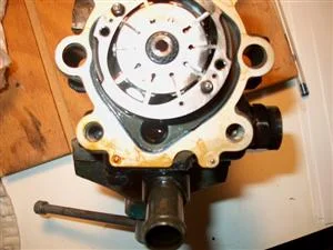

Did not take many pics as I was struggling with holding the parts while wrenching and nothing out of the ordinary that the FSM does not show, so here is a shot for the threads sake.

Part 2 - the Correct way
I developed a small leak - nothing big, but a leak just the same and it was annoying after rebuilding the power steering vane pump and waiting for the parts. At least the second time is so much easier, I know what to look for and I know what to avoid. The real key to this job is holding the pressure feed tube in place while taking it off and putting it back on - if you can do that, the rest is straight forward. Oh, and catching the qt of fluid that will leak out :)
The FSM was a little confusing to me:confused:. Just to prove it, it states that both lower engine covers are to come off - er, what for? For the rebuild: It does not have the greatest picture or diagram and indicated that the dimples on the main gasket were to face down - so the first time without using common sense I just put them down and put it back together - See photo number 1. This should have been obvious to me but for some reason it was not (did I mention I am not a mechanic by trade). The hole is the power pump and it uses enough pressure to knock away a piece of the seal to the main gasket and caused a dribble leak.
Photo number 2 is the correct way - to me the dimples are up, but at least it fits better now and it did not leak in the first 20 miles, fingers crossed.
At least the pictures show the interesting pump system with the 10 vane plates that fall out and all over the place - very interesting design.
Cheers - livestrong
