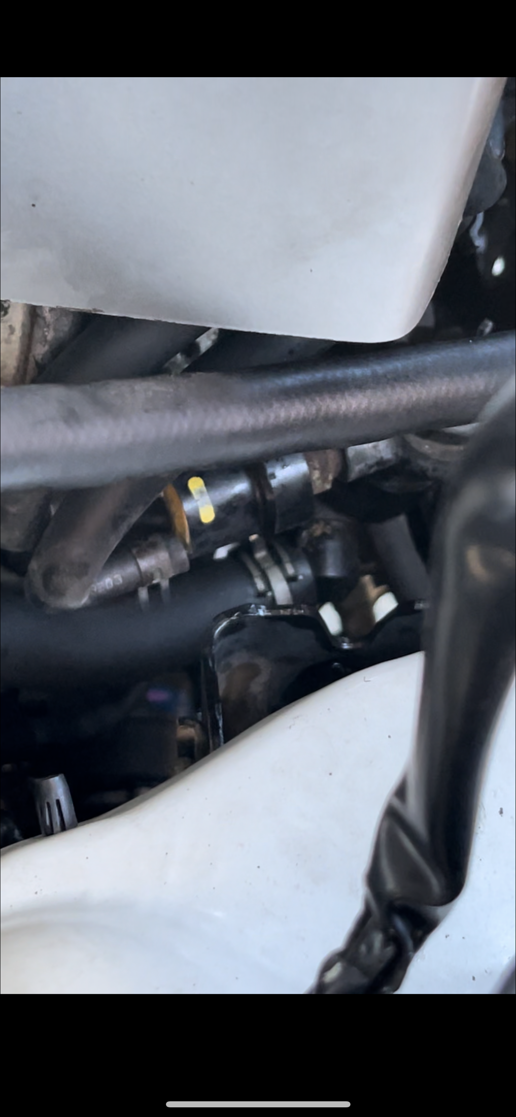

I highly doubt the pump would fail in a way that would cause all of the fluid to drain out so quickly. Much more plausible a hose ruptured or popped off the reservoir (you were just working on it), and once it ran dry it killed the pump.

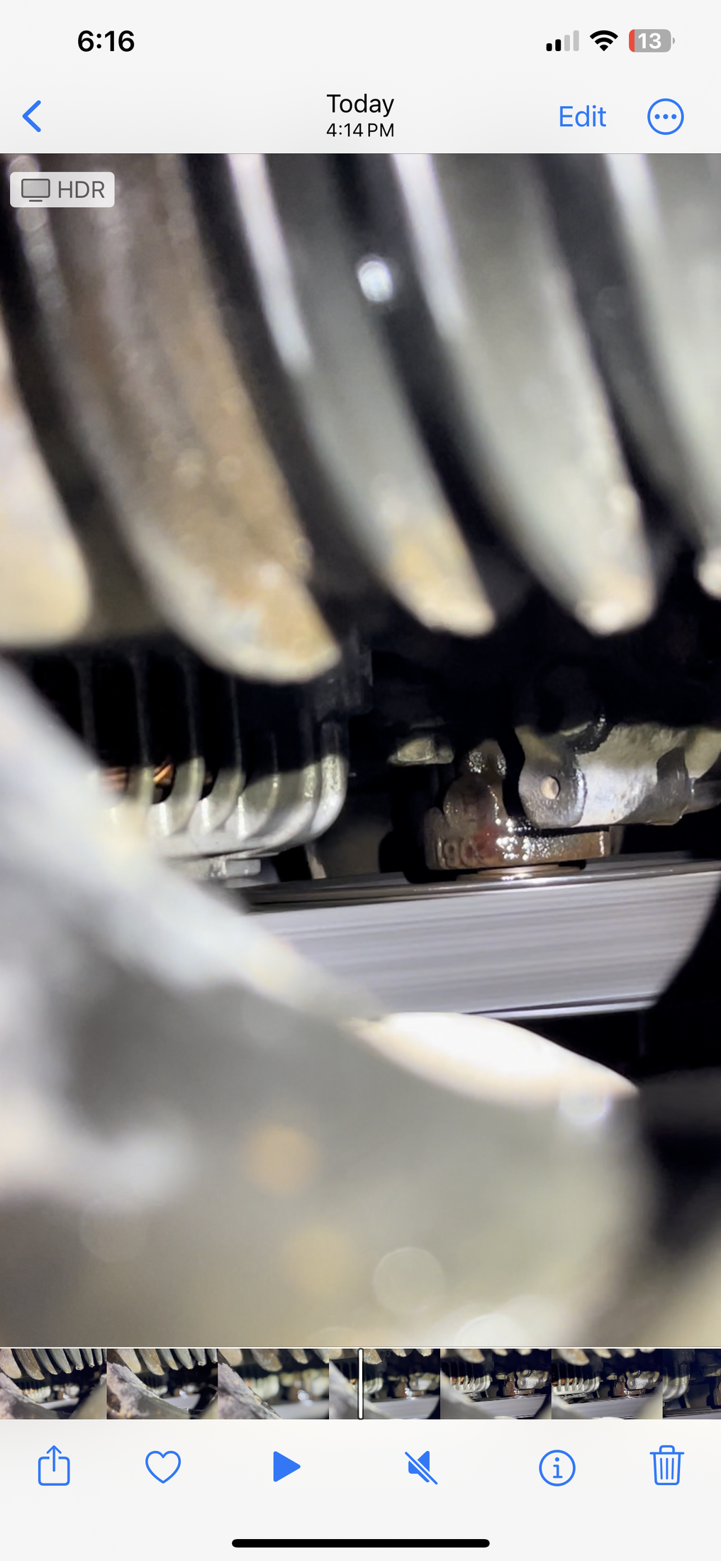

I checked the engine bay and took the first two pictures. Do you think this pipe is popped? The guy says there's nothing wrong with this pipe.
The third picture shows them trying to show me the fluid was from the pump

It's very strange that when I was at the dealership, the fluid was leaking extremely fast, with the reservoir emptying within 10 minutes. I tried twice, and it leaked completely just from starting the car and letting it sit there. However, when I brought the car home and parked it in my garage, the leaking almost stopped.
Does anyone know why this is happening? (During this time, I did not add any stop-leak products)
