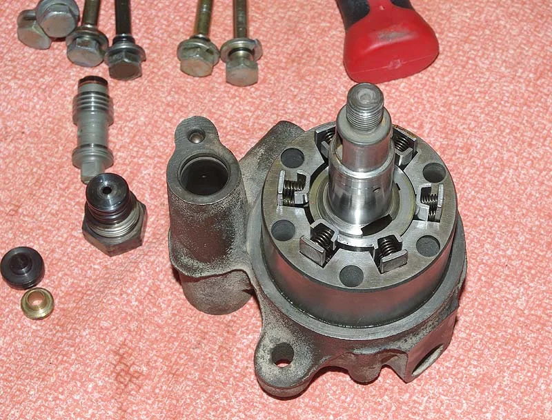

my pump is doing the same thing, I must have installed the slipper springs wrong
so my slippers blew out everywhere and I have no idea how they were mounted the FSM was no help either
I installed my slippers with the key way pointed to the right side of the picture
I can't tell from the lighting in your picture, are they the same way as mine? (Post #10 in this thread)
https://forum.ih8mud.com/diesel-tec...60-part-search-help-various-other-fixins.html
From what I could find in the link above the photo in post 10, this is the correct way around, but perhaps it is wrong. I am also wondering if the pressure valve is assembled wrong. My steering seems to get tighter the further I turn it with the wheels on the ground. Off the ground it is the same lock to lock, but stiff.
MScatena: Just FYI, the FSM does show which is the correct way to install the slipper springs, at least in the Aug. 1980 manual. I didn't check the later ones. If you look at the Aug. 1980 manual (36044E) it shows the correct direction of slipper springs on pages 8-118 and 8-119.
I have the 84' FSM and I installed them in the direction the picture showed, but what it said to do was use the alignment symbols. My parts didn't have the alignment symbols so I followed the pictures. :bang:
I'll find out this weekend for sure if that was the issue.
Yep, borrowed another pump, and the slippers are the other way around... Works like a charm...
