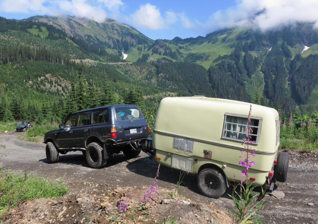

Hey guys,
I'm new here so my apologies if I've made a mistake on where to post.
I've been looking to purchase a Diesel 80 series and found these two in Vancouver.
I think the second one is also for sale on MUD (Link).
Questions:
1. Do you guys know the car/driver?
2. In your experienced view, what do you think? Do they look like reliable long-lasting vehicles?
3. And a long shot - but how much $$ do you think they would take to get into top highway shape (I'll worry about off-road worthy later)?
My goal is to get a vehicle that I can take into the bush when camping and trust it to get me back out. I travel around Western Canada and into the Northwest Territories reasonably frequently too so it must have good highway manners. No rock crawling or anything. Lastly, it has to be able to help my family when towing one of these, a 13ft 1970's Boler Trailer, for front-country camping.
Though any mid-sized SUV will be more than capable of that since the trailer is only ~1200 lbs (550 kg) loaded.
I've always loved Toyota and the Land Cruiser platform so I started by narrowing down my sights from there. I decided on an 80 series due to their apparently better highway manners than and 40,60,70 series. I also ruled out the 100 and up series due to cost and increased electronics (elec. is not my thing).
Then onto engines, I liked the increased fuel efficiency and simplicity of the diesels, plus the BEB is a one time job whereas the the head gasket failures seem to be repeating. HZ i thought might be a little under powered for the mountains. HD-T, HD-FT, or HD-FTE would all be great for me, but HD-Ts seem to be much more frequent a find in Canada.
Let me know if my reasoning seems wrong anywhere. I'm more than open to hear opinions and bounce ideas around.

Electric Dyck,
Gorgeous pictures! I am very jealous. I really like the one looking out over the cobbles of what appears to be a river plain and the mountains in the background. Where is that?
That’s one heavy duty trillium frame. Two years ago we fabricated a new Boler frame after finding a crack. We kept it light though as we still want to be able to tow with a smaller vehicle if necessary and we figured the fiberglass wouldn’t cope well with any remote travels anyway.
Can I hear your story on the re-gearing? What tire size are you running and what did you re-gear to? How do you like it on the highways and hills?
