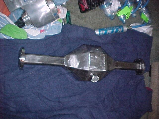

i ordered up a set of portal teks housings,:grinpimp: talk about beefy

Damn cool chunk of steel...................
